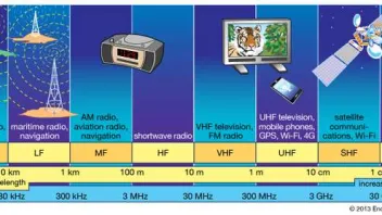

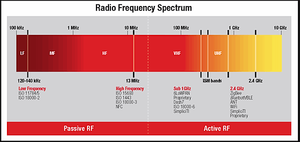

  • To be honest: I don't know.
    But I think the issue is "interesting" I've investigated a little outside-the-box... :smiling_face_with_sunglasses:
    Infrared led light waves range from 300 GHz to 430 THz.
    Radio Frequency waves range from 3 KHz (VLF) to 300 GHz (EHF).
    This leads to the following question:
    Is there perhaps a RadioFrequency or other IR device intererring with the remote? This could be anything from a (Web)cam with IR (nightvision) leds to a Satellite receiver/dish frequencies...
    So worst-case there is a transmitter nearby at 300GHz, and your IR remote transmitting close to 300GHz also.
    This would only explain the behaviour if the Z8 RCU IR LED is capable of switching wavelenghts OR the interfering RF/IR device is switching wavelenghts. AND then the worst case scenario, result of this frequency switching is interference and in all the other scenario's there is no interference.
  • Thanks for the response DDD. I haven't added any new electronics to my house since this problem has started so I'd be surprised if anything was interfering with the signal. Also, since a 5 minute unplug of my z8 returns the remote back to working fine (at least for that day) makes me think there's a problem with the z8 box itself and not the remote or any outside signals. Any other ideas? I'm not looking forward to a lifetime of having to unplug the box first thing every morning, lol
