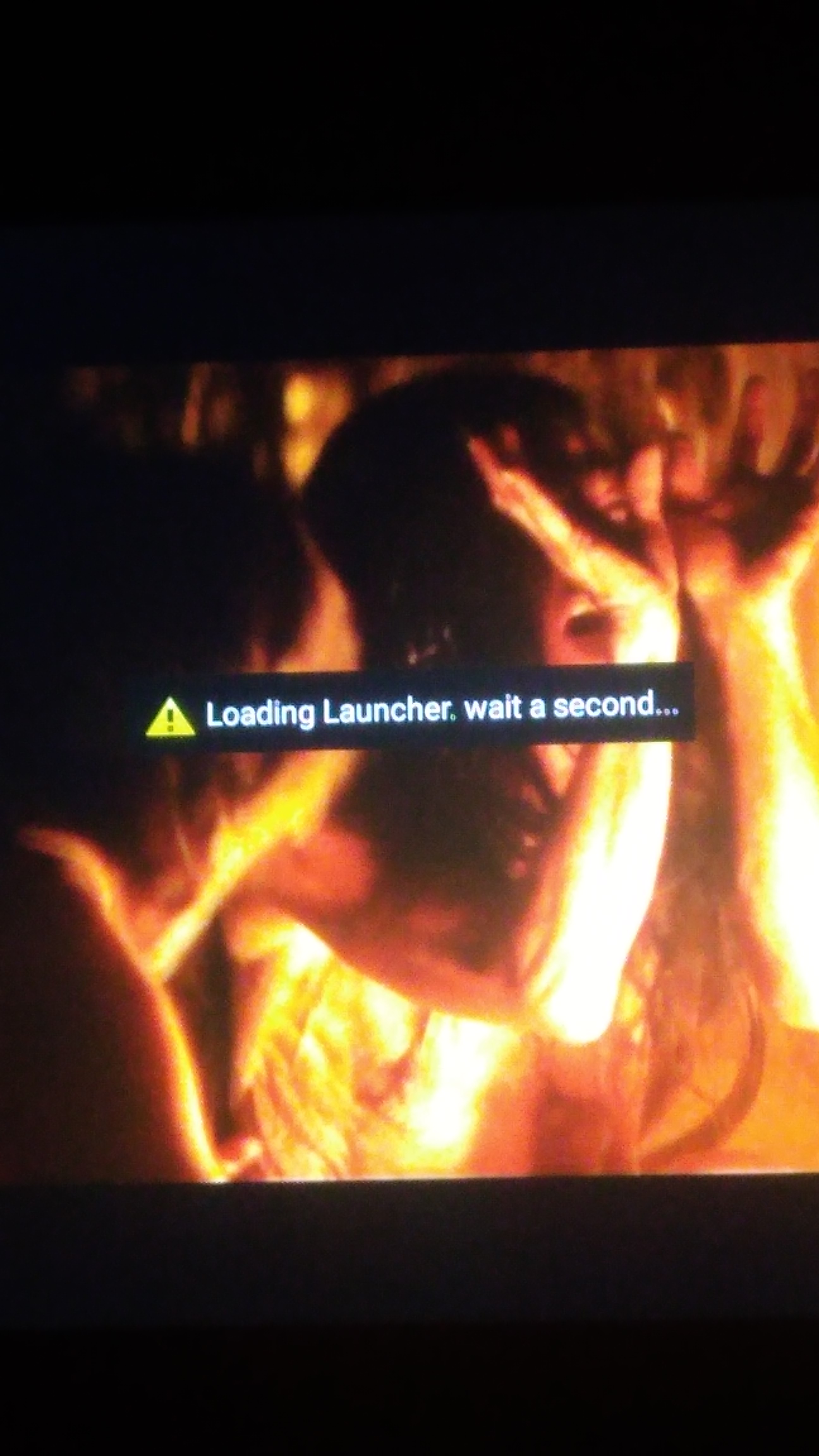

    A few days ago I bought a new Formulerm S Turbo. It was working quite fine until yesterday when it crashed. I've uploaded a new channel list and after reboot the receiver does'n want to wake up. The front LCD displays "boot" and "load" for a few seconds and after that it becomes totally black. After some time on the TV there is an info "The laucher does not response". Does any one know how can I restore the system? Can I do this myself or it needs to be performed by the authorized service (it still under warranty)? What could caused that issue?

  • Some problem i think... I sent a channel list via usb. Automatically it's restarted and then black screen. I put the "update.ird" file on formuler 4k s turbo and pressed channl up at power up. On display of decoder write "udate" - it's restart but - colored circle on screen tv but then.. black screen. Pressing other botton on remot control on screen tv is write "'l'app Launcher not risponde" closed app or attend but the 2 choices not work and black screen again.

    I have the same problem... I've uploaded a new channel list and the decoder doesn't want to wake up after reboot. I tried to recover the system using the "update.ird" (it helped last time) but this time it doesn't work. I have sill "laucher does not response" on my screen - same as robertjust. I used "*.nsvc" channel list file which was previously working without any issues. The Formuler's channel list becomes my nightmare... :S <X
