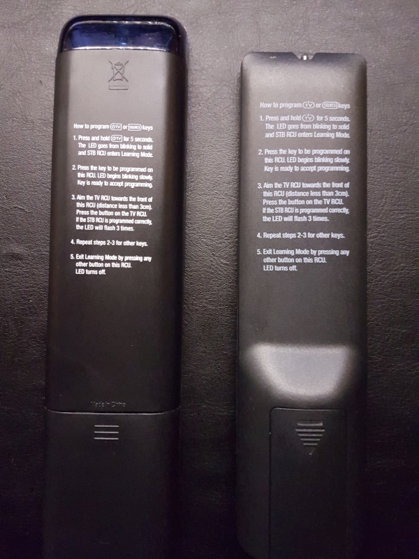

  • I have a picture of the remote I received with my Formuler Z7+ which is different than the remote shown in the video in the first post of this thread.
    How do I program mine so that I can turn off my TV? This way I don't have to power off my Formuler Z7+ with its remote and use another remote to power off my TV.

    • Official Post
    Showed RCU is for North America and Canada area and have other specs. Showed RCU on video in first post is for EU area.
    I don`t really know if yours can be programmed, i don`t have any sample to check this. Do you have on backside printed how to for programming on RCU? See Attachment.
  • No it's blank. I guess that means I can't program it. I am from the U.S. and ordered it from Canada. Is there a way to buy the programming remote or are there other remotes that work with Formuler Z7+?
  • I have a Logitech Harmony hub with the smart remote and I am able to control all of my devices with it. They didn't have the Z7+ listed a compatible model yet but the Z+ was on there and it works and I haven't had any issues with it. I'm not sure if the cheaper Logitech remotes would work but it could be worth it.
    • Official Post
    Don`t know what the seller in Canada all have, but you could ask him if he have EU Model for sale. Should not be so expensive and yes almost all Formuler RCU`s works with all Formuler Boxes, even with E2 Boxes. I would suggest you the small one, have nice button pressure and is much more silent then the other one.

  • Don`t know what the seller in Canada all have, but you could ask him if he have EU Model for sale. Should not be so expensive and yes almost all Formuler RCU`s works with all Formuler Boxes, even with E2 Boxes. I would suggest you the small one, have nice button pressure and is much more silent then the other one.
    I finally found that remote. Now I can turn off/on my tv and Formuler with one remote and don't have to hear that clicking sound from pressing the buttons anymore. Especially when changing the volume/channels.
