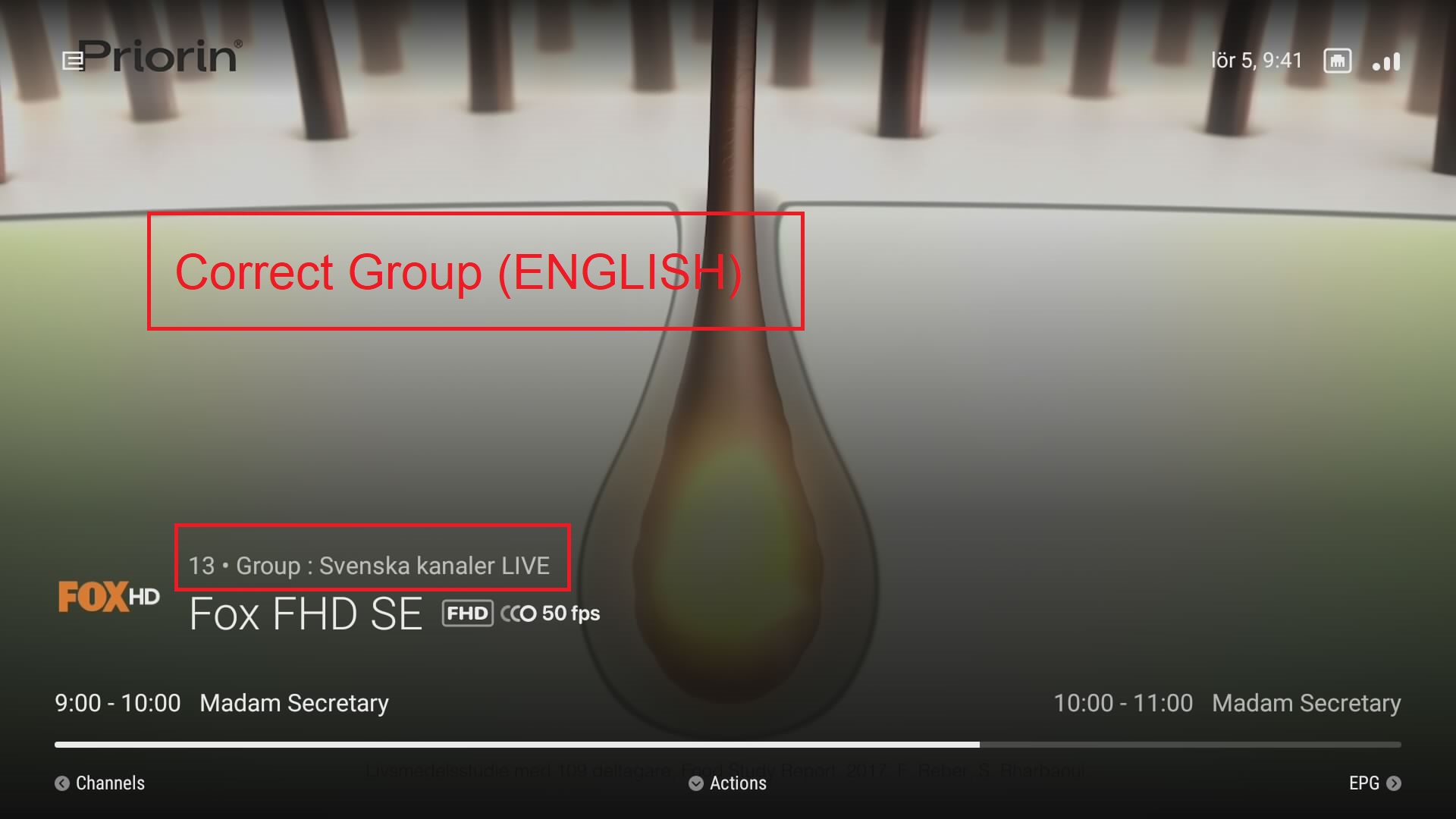

I did notice that but still want to use the english translation because the group name in live tv (info) is correct.
In swedish it would be "13 • Grupp : " not "13MenyGrupp : ".
I know that is not a problem but if i shall be picky so wth ![]()

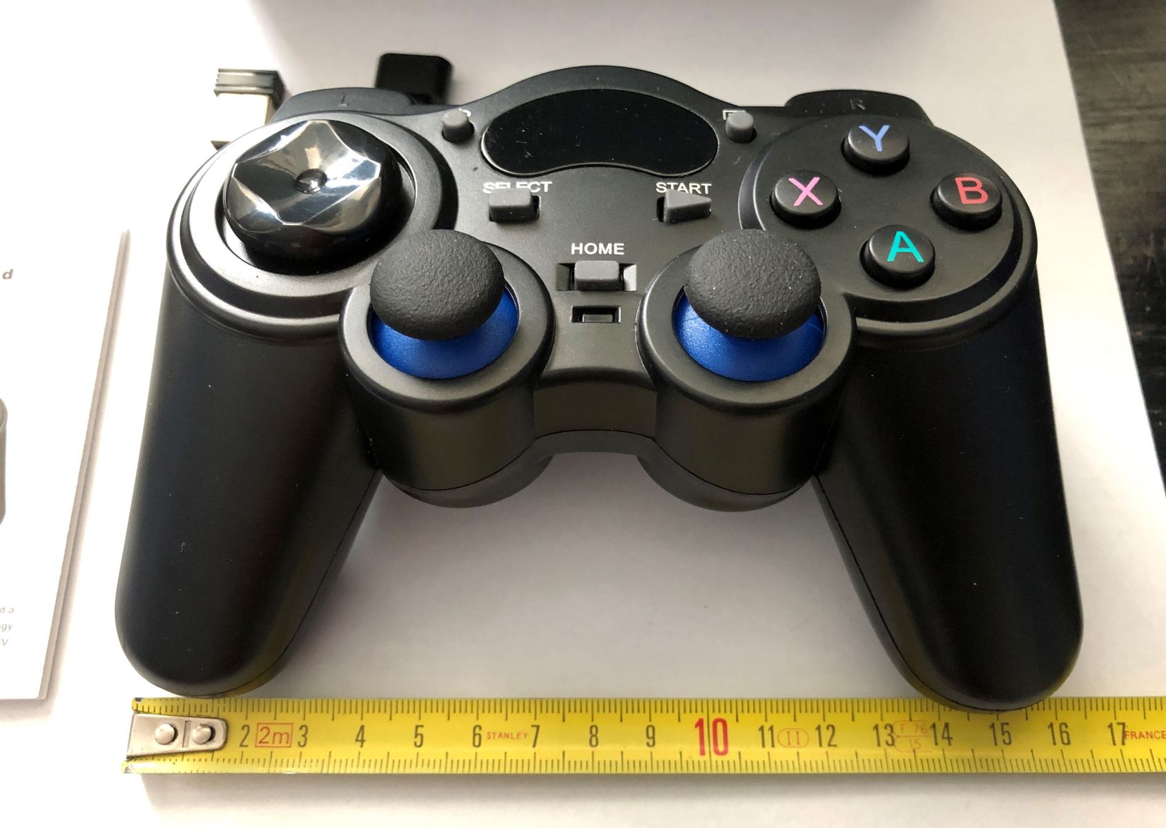

I want to share this GamePad TGZ-850M from China that works great with Formuler Z8.
Price was €12
The manual is not well translated to english.
The gamepad comes with this:
* BOX
* MANUAL
* USB to MicroUSB ADAPTER
* 2.4GHZ USB receiver
I did not get this to work at once because the gamepad was in wireless ch1.
To get the gamepad work in Z8 i did push the HOME button on gamepad in about 5sec to get into ch2.
I know that you can set some other functions that is not present in the manual either.
Where to get it? Just google it ![]()
