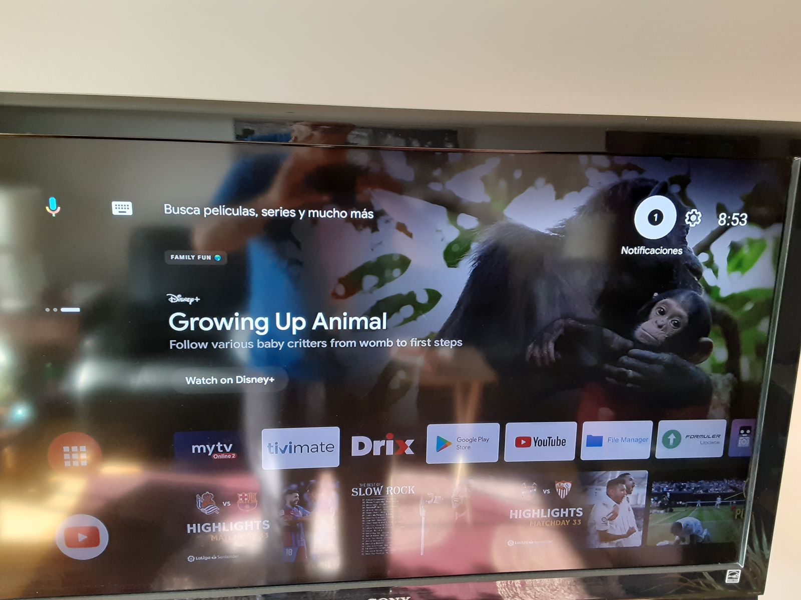

Hello, good morning. I have a GTV and everything was fine until yesterday . Yesterday I refreshed mytvonline2 and from that moment I have lost all the EPG, and I have not been able to get back my EPG for more than 24 hours. I have Tivimate installed and in this application I have no problem. I attach pictures.

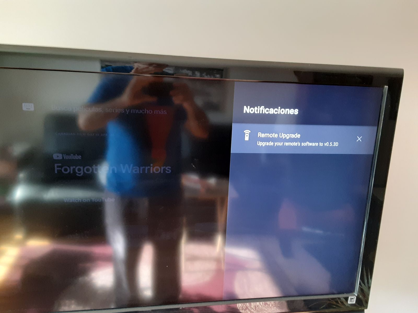

I still have on my GTV the version v.1.1.15 on my Remote . Is that normal?
