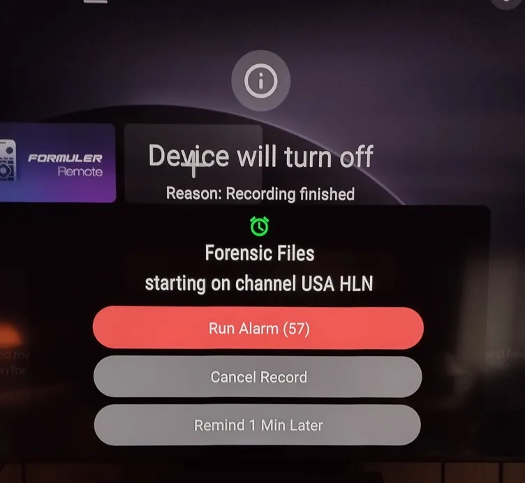

My recording problems continue. For example, I had a couple of recordings scheduled back to back, one 3 hours and one 2 hours. Oddly, they both quit at 17 minutes and 4 seconds. In the notifications, I saw "Remarks: (7)". Anyone have a clue what that means?
Another time, I was watching (same channel) when this same recording pair started, alert that recording was starting for both, recording light on, Z11 shutdown when finished, etc. Notifications showed both recordings started/stopped as scheduled. When finished, both recording were empty.
Other recording fail randomly, sometimes showing notification, other times not. Some succeed.

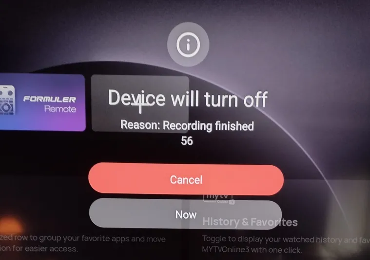

This morning I turned on the TV to see what adventure awaited! Only a single recording instance programmed, should be easy. When my 0500 recording tried to start, I got the Shutdown prompt, then after 15 seconds I got the Recording Start prompt. As usual the Shutdown reached zero first and the box shutdown. It then rebooted and went through the loop again. It did that 5 times, then finally began the recording about 10 minutes late.
Totally normal, right?
Maybe finally starting the recording got it out of its system, but judging from past performance I doubt it.

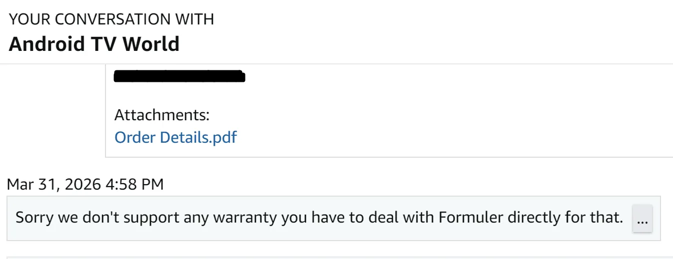

So if Formuler isn't responsible for warranty, and the seller says same, who do I see? Bob in Budapest? Tim in Thailand?
Believe me I'm as tired of this as you are. Please advise.

So what the deal on warranty replacement? Formuler says vendor, vendor says Formuler.
I'm sure if the vendor wanted to continue selling Formuler, Formuler could add some leverage if they wished.
Awaiting your reply.

So I guess it's the warranty route unless you can offer some support from Formuler devs. A dozen logs and no reply.
Note to seller:
Hello. I ordered this item in April, 2025. Since September, I have been going round and round with the Formuler support forum. Tickets can be referenced
Here - Z11 Stops Recording Randomly, also Remote Problems
and here - Z11 Pro/BT1 problems with recording.
They have not been able to resolved these problems and I believe I simply have a bad unit. I would like to get replacement under warranty. Please advise ASAP. Thanks for reading your reply. Order details are attached. Let me know if you need anything else. Thanks again.
Problem first reported in September last year.

So I turned on the box at 1115 AM, it popped up the 60 second prompt to start recording the show I had scheduled for 5 AM as soon as I started MTVO3. I canceled that.
At 1120, I set a recording for 1130-1200, it powered on, recorded, and powered off.
I also set a second recording for 1230-1300, it powered on, recorded, and DID NOT power off.

So last night, I had a program set to record. Oddly enough, the program recorded in full, and the Z11 seemed to shut off, but the HDD light was still on. The program I had set for the AM did not start to record. I had to pull power from the Z11 to reset it, as it did not respond to either the BT1 or the IR remote from my Z8.
