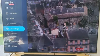

Hi Sam,
Took video with my phone so that I could show both the TV screen and the RCU.
- Live TV
- Pressed button with 3 horizontal bars to show main MOL2 menu.
- Went down to Recordings and pressed OK to select.
- Shows Today’s recording. Selected the only TV clip recorded.
- Held down OK button for several seconds. Goes into playback.
Here's the video link:
Timbo

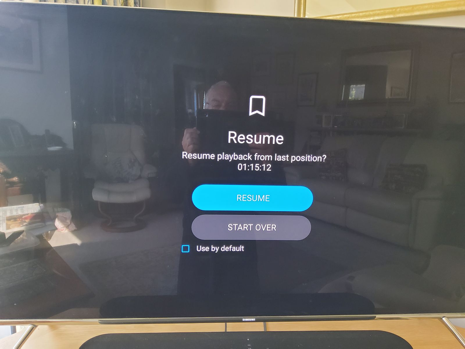

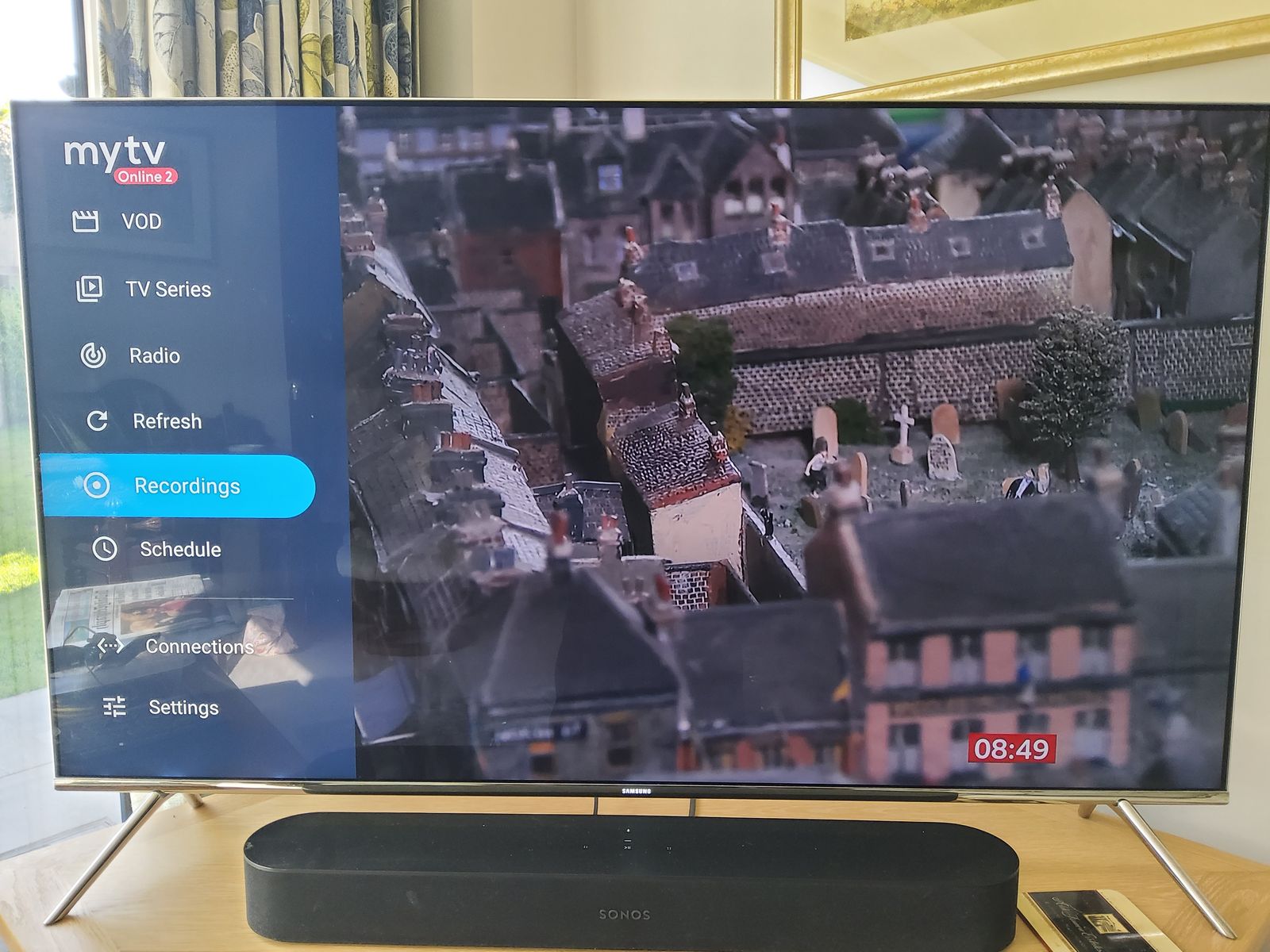

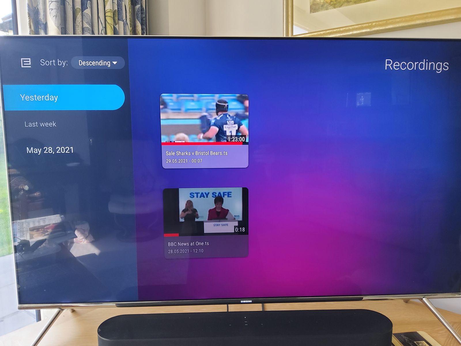

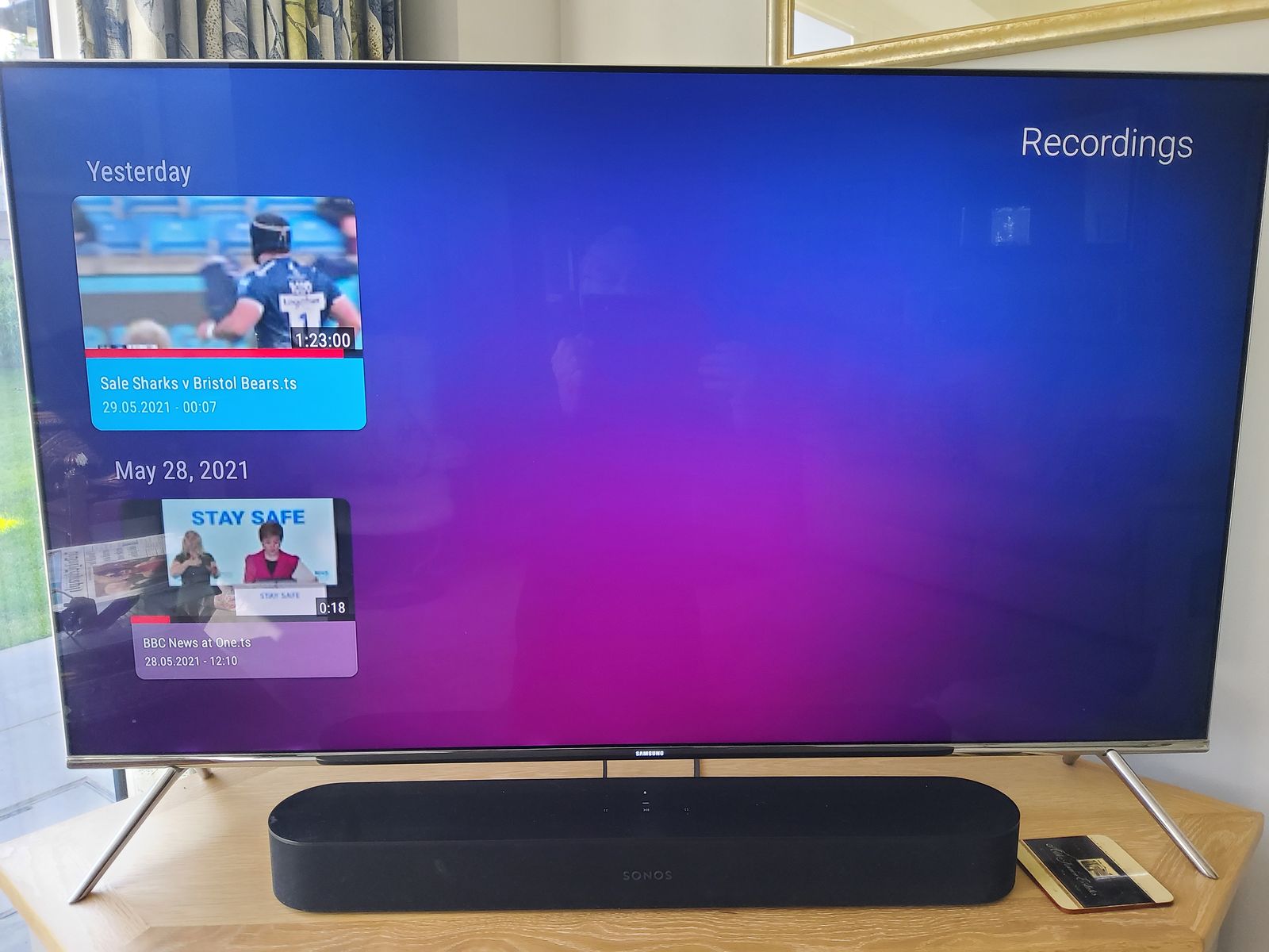

- I went into MOL2 and clicked on Recordings (see attached screenshot Formuler 1).
- It came up with the list of recordings that I’d made yesterday (see attached screenshot Formuler 2).
- I highlighted the first of these recordings (see attached screenshot Formuler 3).
- I pressed the OK button on my IR1 remote control for several seconds.
- It came up with the resume playback option (see attached screenshot Formuler 4).
Still unable to delete recordings.
