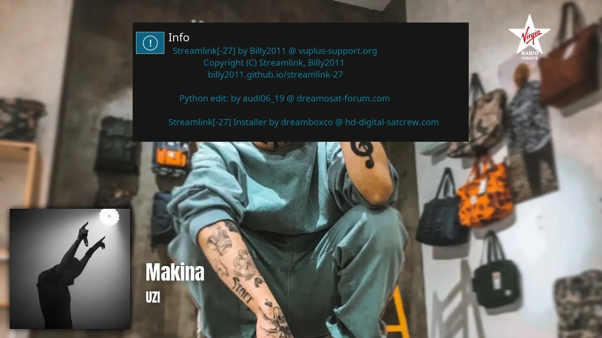

Now available as a plugin with installer and livestream updater for All Images
Streamlink Plugin - is a live streamer for Windows, MacOS, Linux and BSD https://streamlink.github.io/
Streamlink [-27] - is supported by Billy2011, who provides the packages for E2 https://billy2011.github.io/streamlink-27/
Streamlink [-27] Installer - I offer it as an installer with all packages and plugins with livestream
Installation instruction
- Install the plugin Reboot the box and open the plugin, then click on INSTALL STREAMLINK [-27], so that all files you need are installed Now you can
- Download live streams via plugins

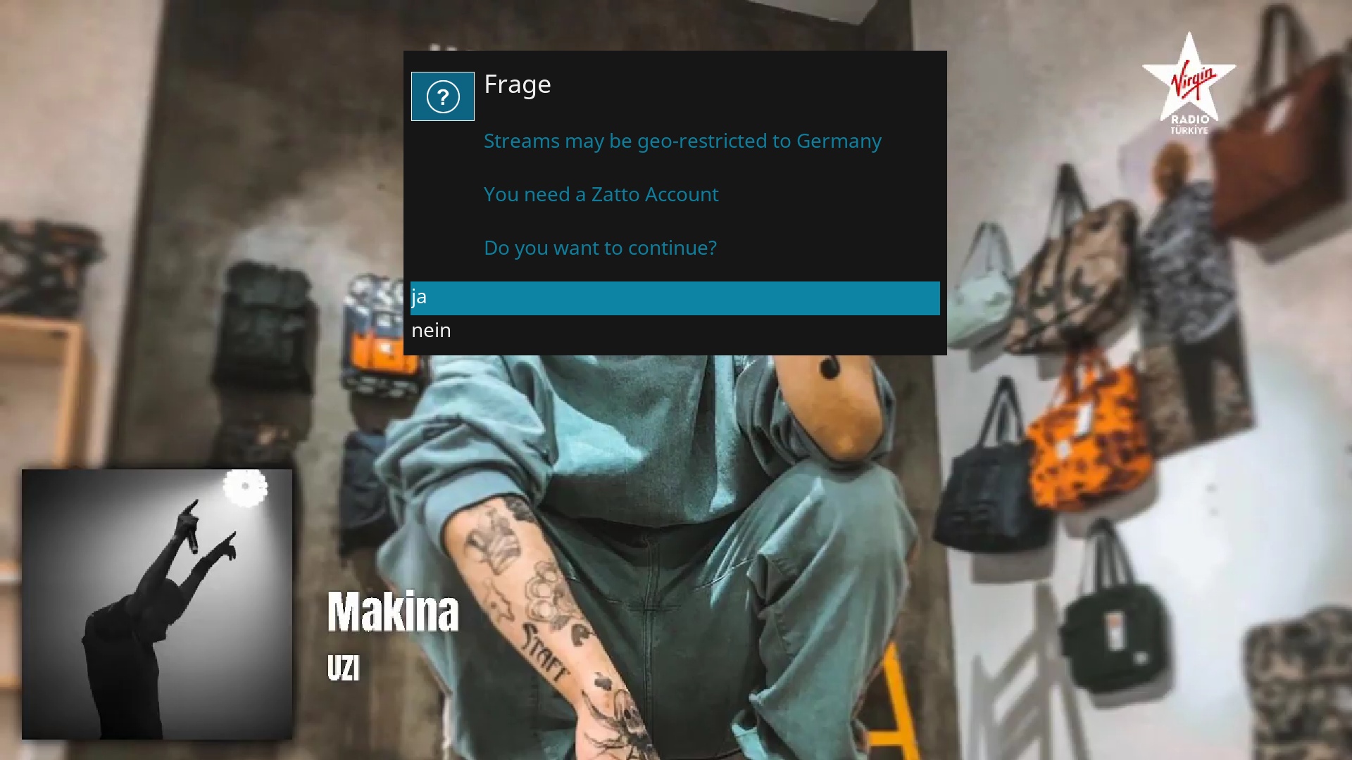

- v.2.6- Add Zattoo TV DE
