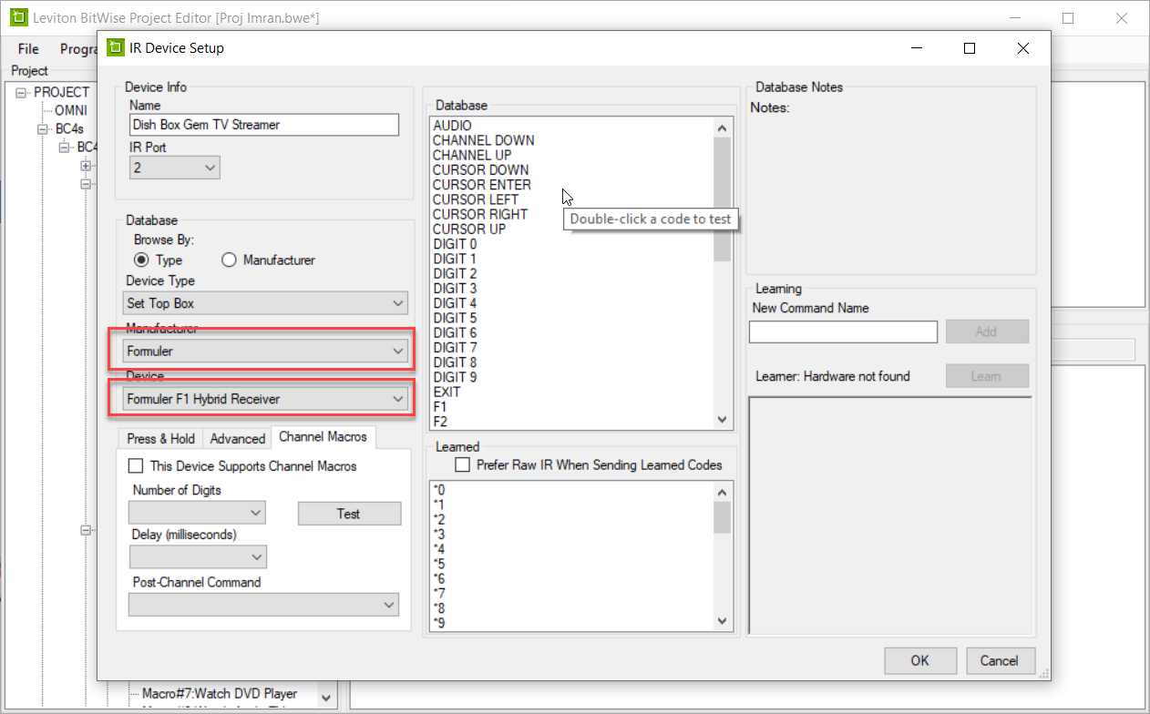

Does your BitWise system have an IR learning function?
I have to buy a hardware.
That's because it's only for their very very old enigma2 machines, not compatible with the Z android based series etc.
so for a very beginner person like me, you are suggesting I can't use BitWise BC4 and needs to move to something else. ![]()
Formuler F-Series IR codes are not compatible with Z10 products.
Thanks for responding, Any idea what can I use for an alternative?
My entire home solution works based on BitWise Controllers and I can't use the Z10 Pro max
Any ideas would be appreciated.
