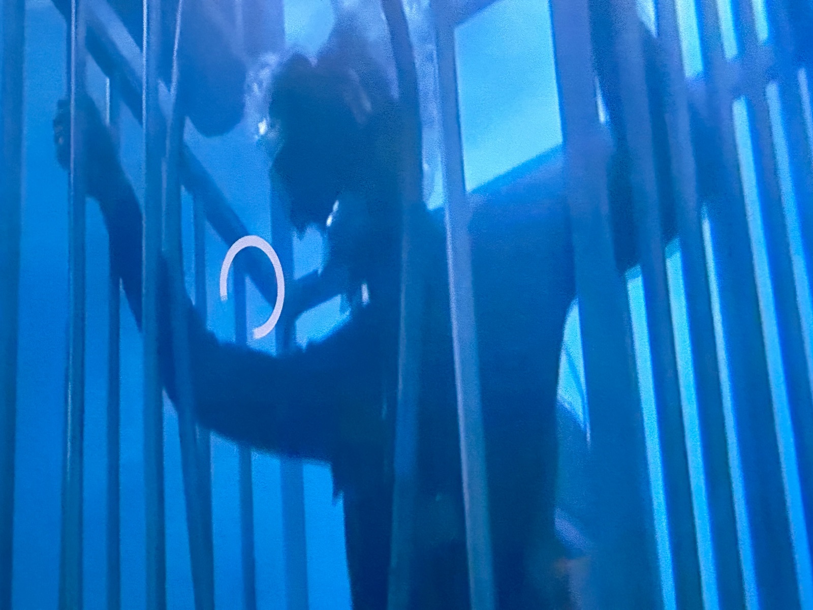

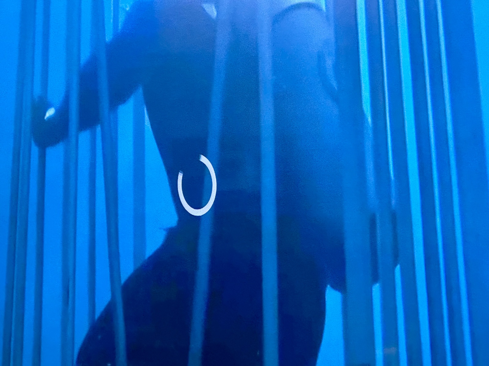

Not sure about what signal bar shows at the time of the issue, I will change buffer settings to ‘Long’ and will monitor both, I’ve also upgraded to the latest Beta version. I will write back here with my findings, tks SAM 👍
22mbps is not enough bandwidth for 4K IPTV, you’d need at least 60mbps to watch 4K IPTV without buffering on any device
See attached picture for reference
I have a strange issue where I see a buffering signal on the screen but live TV continues. I took a quick video to demonstrate. If I switch the channel it goes away. Any idea what/why this is happening?
Latest MOL3 version, I have a wired connection and VPN

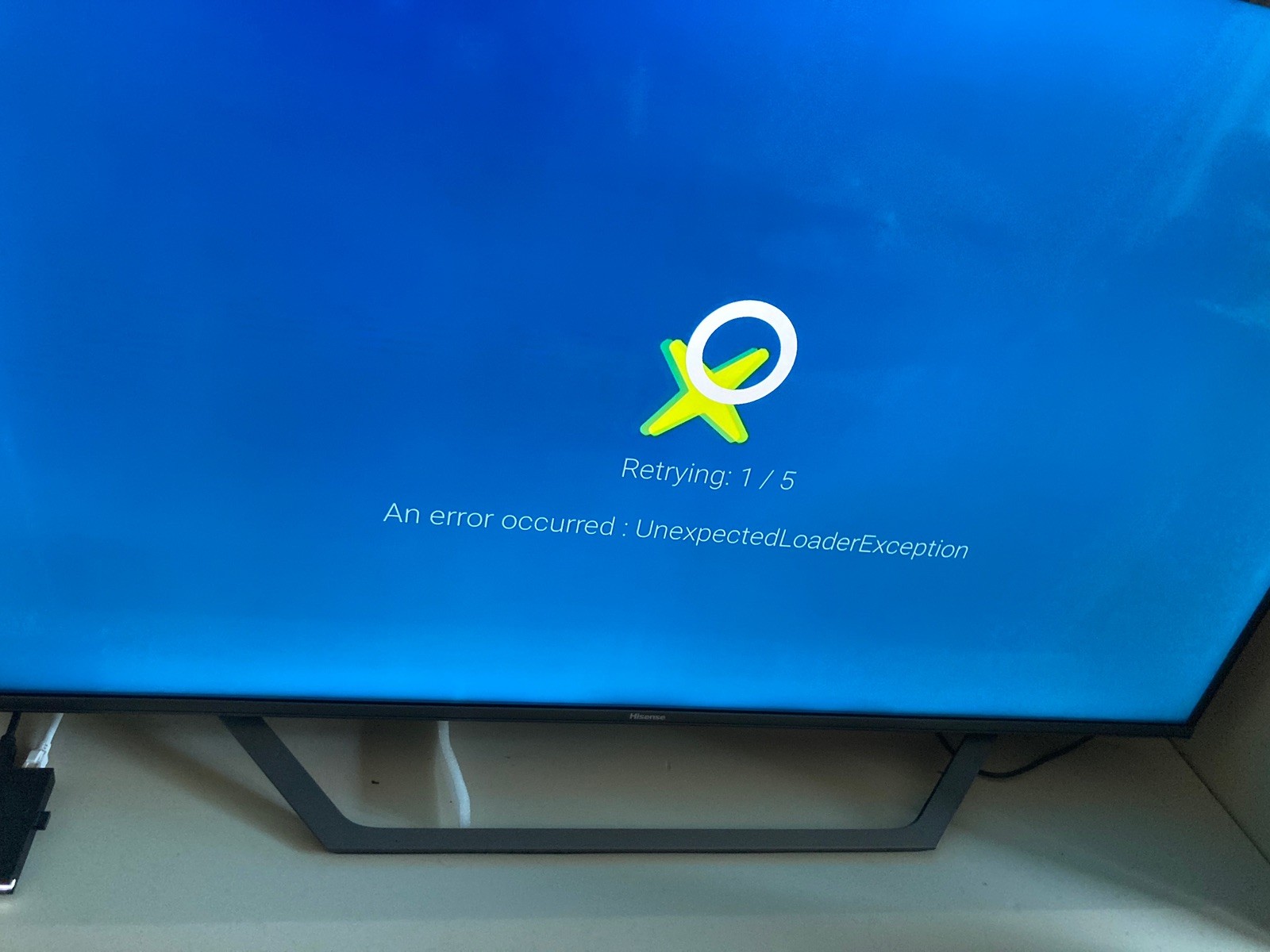

Just a quick update, I’ve not seen the UnexpectedLoaderException error again after doing the factory reset, I think we can close this thread.
Btw: great update, I found no issues👍
After doing a factory reset I’ve not seen the UnexpectedLoaderException error at all, it looks as if the error is resolved after resetting, thanks Sam for advice 👍
I’ve done a factory reset on both devices, I will update this thread with my findings
I’m getting an intermittent error ‘An error occurred: UnexpectedLoaderException’, the strange thing is that the message just appears but does not cause any streaming interruption, the only way to remove the message is to change channel.
The error first appeared when I installed the last beta release and now again with today’s official release. I have 2 z11 Pro Max devices and this error occurs on both.
Any idea, howto solve?
