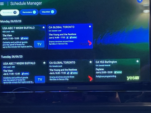

Just noticed this today. We have scheduled a recording for 16:30-17:30 Mon-Fri. It shows correctly in the Menu->Schedule list as not happening next until Monday. However in the guide we see a red indicator from 16:30-17:30 today (Saturday) and tomorrow (Sunday). It appears to be strictly cosmetic since I can schedule a recording today at 16:30 without a conflict coming up. Like I said, strictly cosmetic but should be corrected.
Ross
