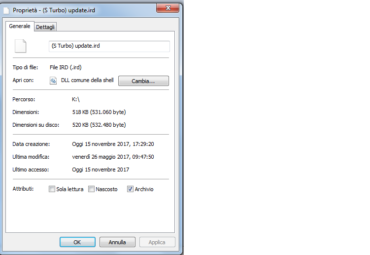

1. Format USB Stick with Fat32, download the file "Factory_reset_sw" and decompress.
2. Copy the attached file (use the proper one for your STB, only (S Turbo) in to USB root (please without other files in root, copy only needed recovery file)
3. Turn off your STB, unplug the cable and plug in your USB Stick.
4. Plug in your Cable and receiver starts to reboot. *. Please click and click the Channel UP button continuously from start on RCU when rebooting.5. When you see "updt" on front screen, it does factory reset.Remove and reset power and all ok

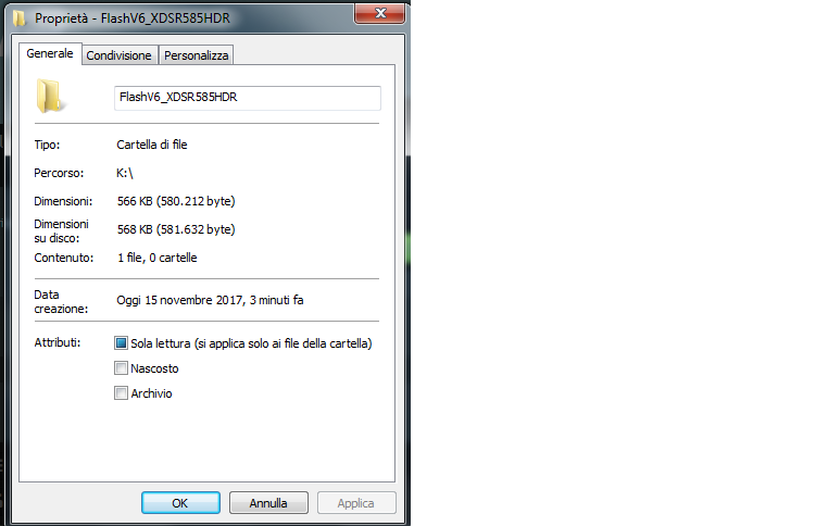

List channel sent (see attachment) -
"You need to make a list of channels and no problem. You have a problem because you're using someone else's channel list. Take your time and make it. Using the remote control the built-in [lexicon]editor[/lexicon] much faster is the list of channels. And save it on the drive for the reserve."
But now that the decoder is blocked how can i do it?
Some problem i think... I sent a channel list via usb. Automatically it's restarted and then black screen. I put the "update.ird" file on formuler 4k s turbo and pressed channl up at power up. On display of decoder write "udate" - it's restart but - colored circle on screen tv but then.. black screen. Pressing other botton on remot control on screen tv is write "'l'app Launcher not risponde" closed app or attend but the 2 choices not work and black screen again.
Help me please -
