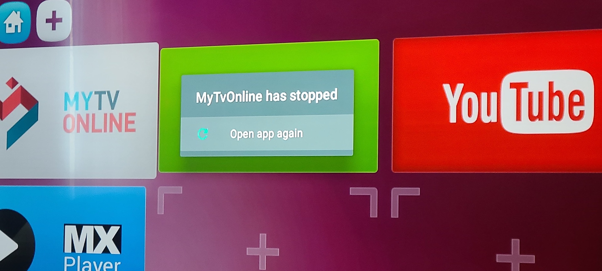

I have rebooted, factory reset this customers box twice with same result MYTVOnline craps out about 30 seconds after starting. Right now she is using TiviMate to access her IPTV since MYTVOnline app is un-useable..and this app is fine works great but wish the Formuler team would find a fix as to why the app crashes right after start.. Maybe if she would give me her box I can send logs to devs to look see whats up
Factory reset is the solution
Have done that with the same results, I know it is an app issue they need to fix
nope it is your ISP connection or IPTV Server issue mine loads up in under 10 seconds
