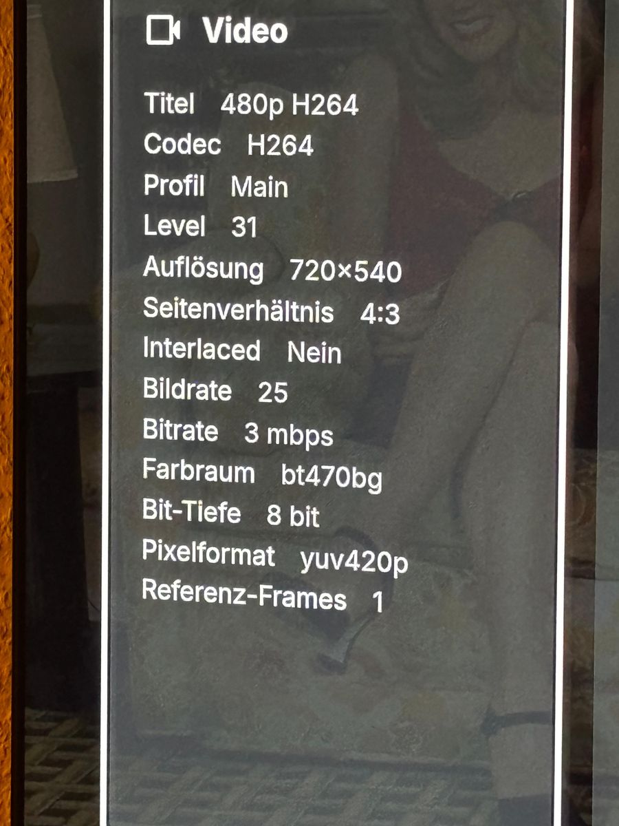

what are your settings on Box -> Adaptive or HDR? Did you tested also with other settings?
it is set to Adaptive. Other settings work like they schould.
Off --> displays it in SD mode
HDR10 --> displays it in HDR10 mode
DV --> displays it in DV mode also
HLG --> displays it in HLG mode
So only adaptive picks the wrong mode.
Normally it was working fine until I started watching this series. Every other content was displayed in correct mode.
Didn`t seen it yet on my side, but would know more about the issue so it can be forwarded.
What says the info of the content, did you check?
Hi SAM,
thanks for your answer. I uploaded a screenshot of the infos about the content, hope it helps
I did another test. My IPTV provider has the same content and I played it in MYTVOnline 3, the same result. It switches to DV-mode.
