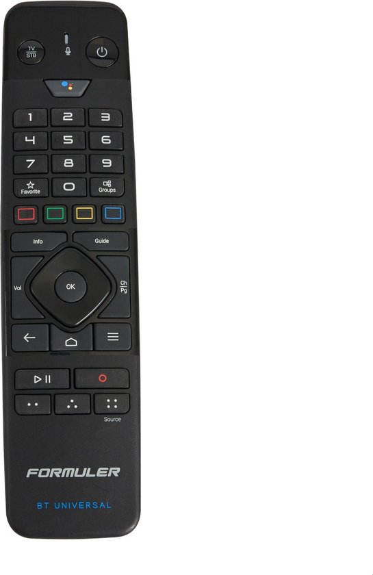

Great found my friend,
But standard at the gtv belong a bt1 remote.
Just curious, did you bought it from official seller? Because the gtv was rhe first with the bluetooth remote i added as image. But if you are happy with the "standard ir" remote it's okay.
Thank you for your reply, but I believe this will not be possible.
My remote control is IR (infrared) only and does not support Bluetooth, so pairing is not possible.After the factory reset, when I start the Formuler device, it forces me to pair a RCU.
I would like to know if there is any way to skip or bypass this pairing screen so I can continue the setup using an IR RCU.Thank you in advance for your help.

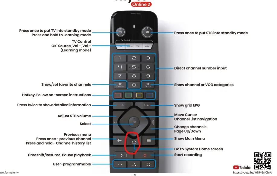

Youn posted in gtv thread.
Gtv has a bluetooth remote. If you have other remote delivered it's not good. You can't bypass pairing mode. If you have a gtv buy a formuler bt1 remote.
You should have the one i attached as image.
