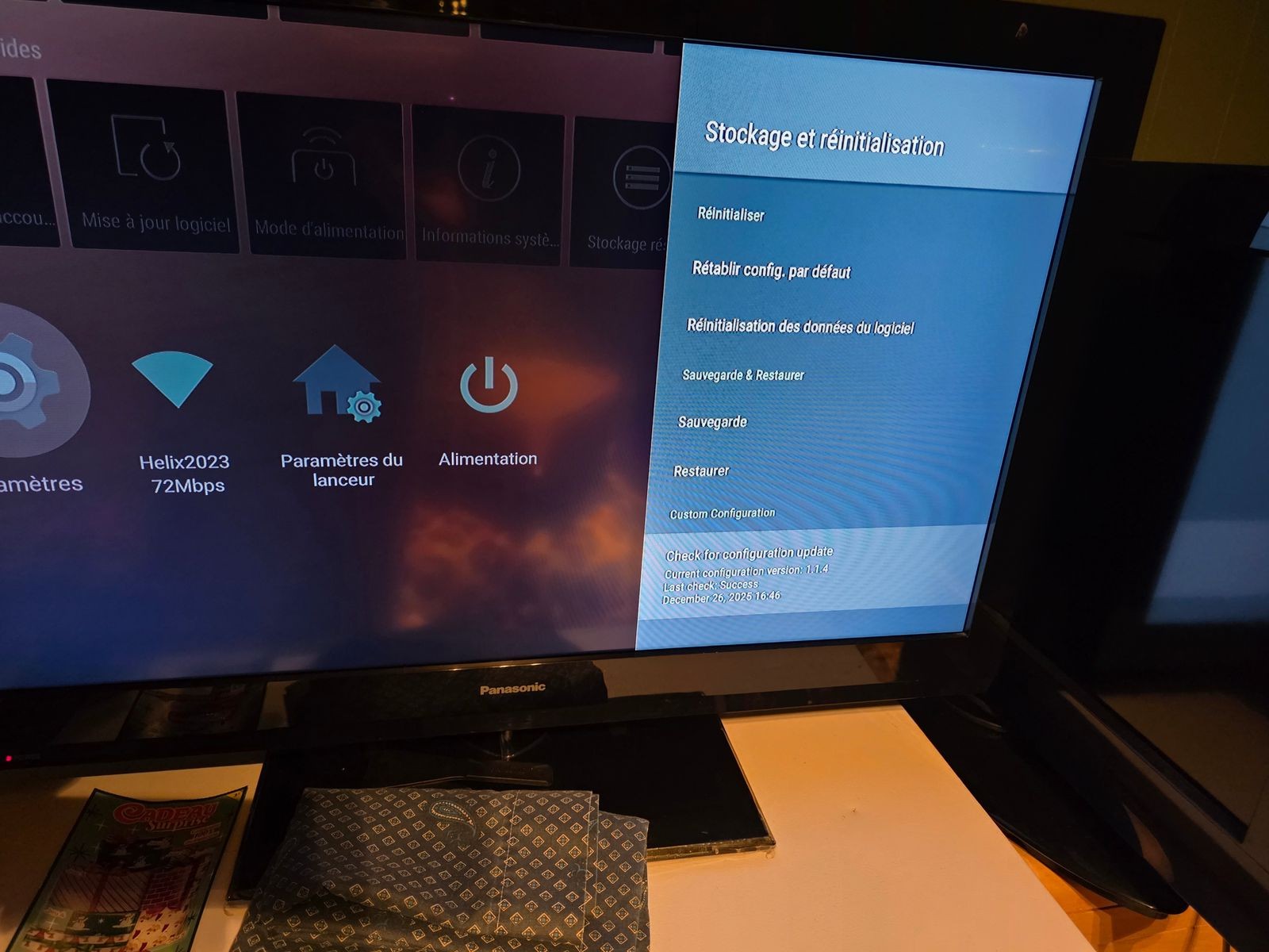

If your box won't find any wifi and you did already factory reset. Looks like wifi card or so is broken.
You use official power supply?
https://www.formuler-support.tv/attachment/5187-20251226-171913-jpg
This photo! Do this and press 10 times on 0(zero)
Just go with the arrows on your remote down to "update configuration" (don't press any other button)
If you are on "update configuration" press 10 times 0(zero button)
The third photo!! That is what i mean!
You highlight "check for update" that is good! But Don't click on that button with OK!!
Just select it and press 10 times on the 0(zero) button on your remote.
then it should reset!

Can you serious not find this settings?
Home > Settings > Storage & Reset, and look for "Check for configuration update"
The check for configuration update?
That you should highlight and then 10 times press on the 0 (zero) button?
