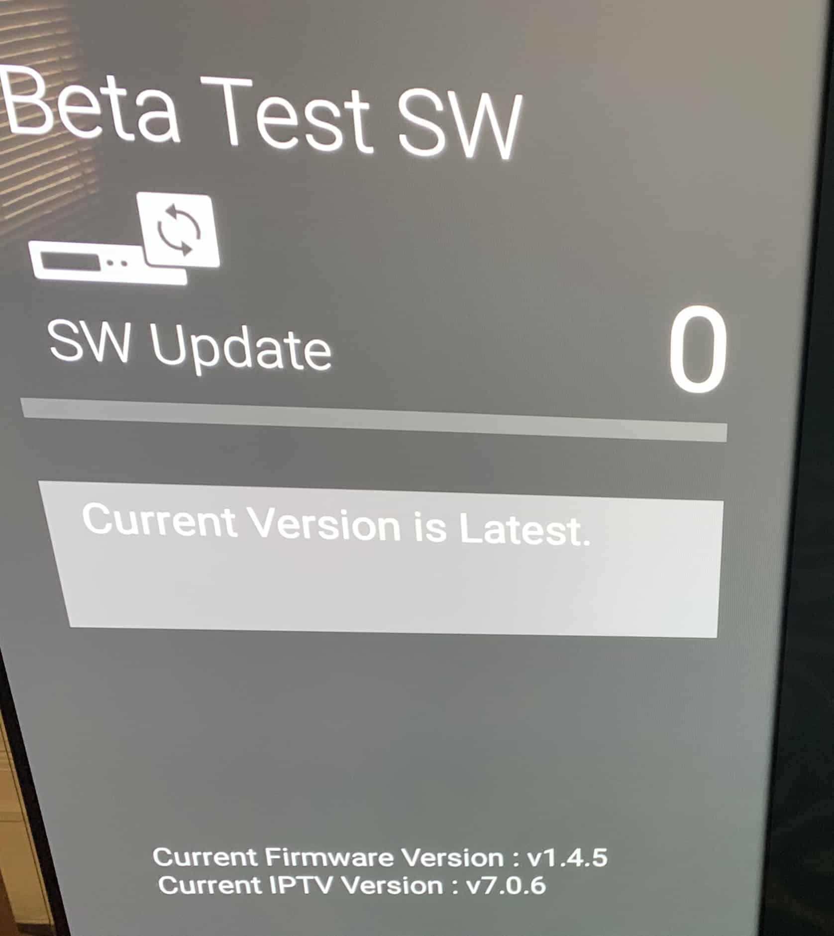

Could you post a screenshot of the Update app in Beta mode, like 175n already ask.
I did already post this a few days ago. Hope you guys can solve this issue for the people it’s affecting we appreciate you’re help.
Any update available for people stuck on Z8 beta v1.4.5 who’s boxing are no longer receiving anymore beta updates?
Do we just wait for the next stable release to clear this issue?
Please post a screenshot of the Update app in Beta mode.
We're aware of a possible issue, and the devs will require your screenshot data to look into it.
EDIT to add:
Please post the SW Update App version that is installed on your device.
You can check this from the Android > Apps menu
Confirming the SW Update App Version 1.0.24.
Please let us know if there is a fix available. Should l carry out a factory reset or just hold tight?. Appreciate all you’re help in this matter.
Thanks for you’re help l will post the software app version when l get home.
Are you not able to see the new 1.4.9 beta update inside the update app when beta mode is activated?
I have this issue my Z8 is stuck on v1.4.5
the software update app is not pulling up the last 2 beta updates. Think there are a few people with this same issue.
Done everything to fix it apart from a full factory reset. Is this issue being looked @?
