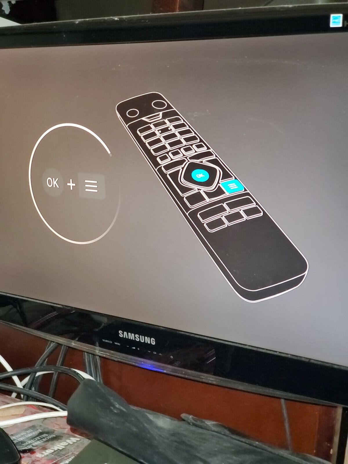

Holding OK + Menu button together doesn`t help? You need to press and hold this two buttons until the white led on your rcu starts to flash.
Thank you for your response.
I tried holding both for nearly a minute - how long does it take usually?
After factory resetting box, the screen is stuck, white line circuling, with OK + pancake menu (3 horizontal bars). Pressing those two keys simultaneously don't do anything - can't go beyond that screen.
