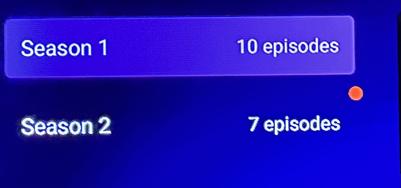

Similar to the above posts I have noticed an increase in unable to load VOD and series.
Refreshing using data sync sometimes sorts it but over the past week or so, I’ve had to go through content sources and refresh that way.
Only then does it pull the information through properly so content can be viewed.

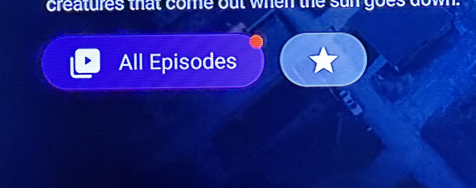

Something that might be noteworthy here.
If you refresh using data sync aside from it being set for a particular time, you of course notice when content has arrived by the notification and then the option to refresh.
However, if like me you have multiple TV services and VOD only service, during data sync refresh, when the icon appears telling you to refresh, don’t press that, go to content sources and you’ll notice that the other services are still refreshing!
Why is this important you may ask?
Well, I mentioned above that when the refresh icon appears due to content being received, naturally you’ll press it. However if content is still updating for your other services, the same refresh icon 99% of the time does not reappear when the content pull is complete.
So it’s easy to assume that you’ve refreshed but actually may not have refreshed everything.
So unless the icon appears. The content pull isn’t known unless you check through content sources.

You’d have noticed before that when a series has new content it will show on its poster “new”
Did you also notice it, now puts a red marker too…
So when you open the show it has this:
And then opening that it shows the series the new episode is within
