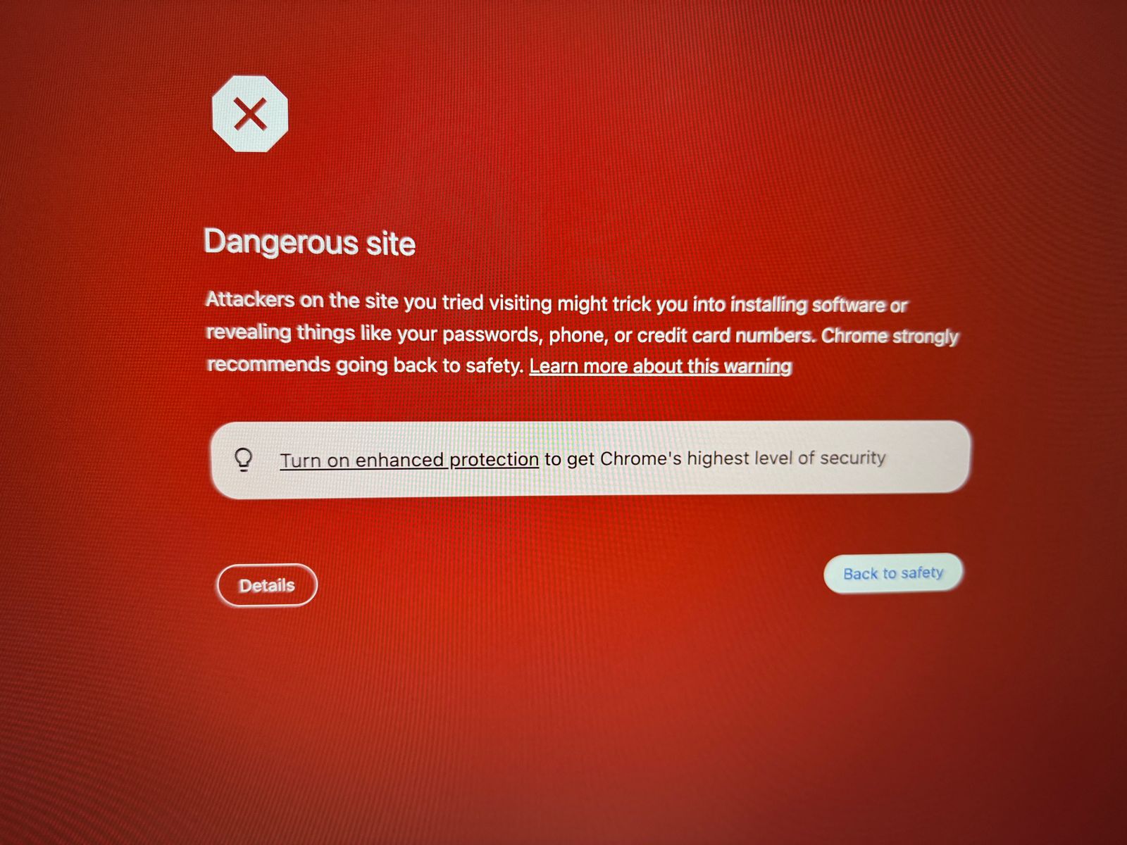

Always delete the "s" from https✅️
Only if your sub is not using secure HTTP. There are subs using HTTPS.
Cheers!
