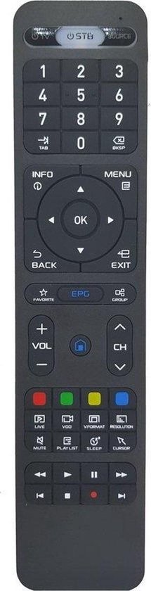

Hello my friend,
The remote for the z7 or z7 5g is the one in the picture.
If you pull out the power adapter and put in in again it should start automatically i thought. Just like the gtv, z10, z11, z12 etc.
And with the remote on my picture you should get the box on.
And if the one you have now don't work, try other. But i thought it are the same ir codes.
