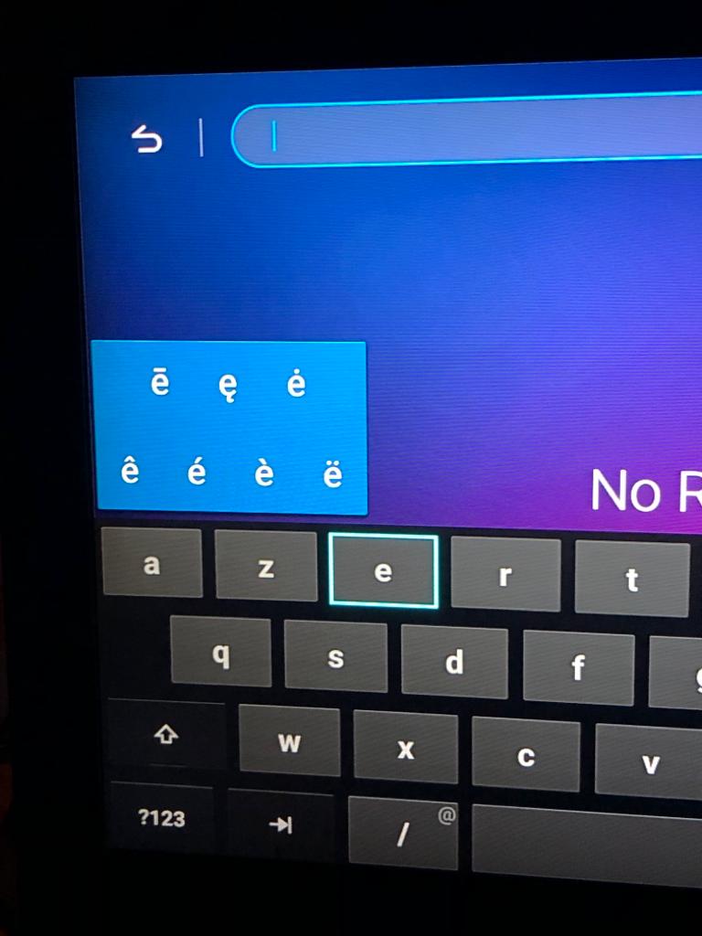

    First bug noticed :
    On the french keyboard, when I press on "Information" button with the remote control on letters such as "A" or "E", I can see the special characters available but I can't choose any of them. Tried using the cursor but same issue, I'm not able to select any of these characters.
    Screenshot :
    I also tried on another Z8 without installing the new beta update, same issue. Is it something already none ?
