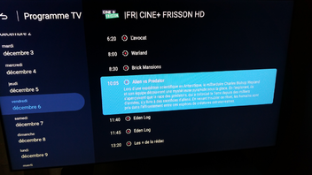

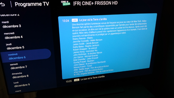

    EPG offset is already set (UTC -1). EPG’s programs are correct, at the correct time, but the descriptions of the programs doesn’t match !
    For example :
    You have a football game at 21h00 and a movie at 23h00 on the single EPG page of my channel.
    Football game’s description shown in MOL2’s single EPG : the synopsis of the movie
    Movie’s description shown in MOL2’s single EPG : informations about the football game
    Is that easier to understand ? It’s simple : the descriptions doesn’t match to the program’s names, while it does on every other apps I tried.
