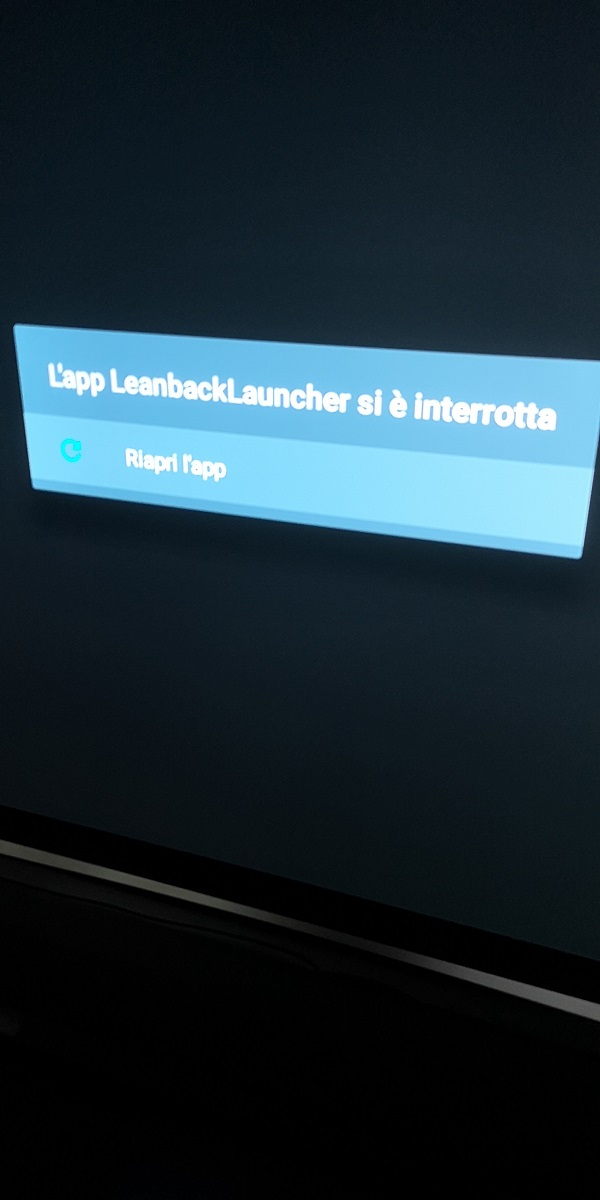

Hi all,
I did it!! But I had to use another method. While trying to touch a little bit all the buttons on the remote control, I noticed that the "resolution" button was the only one that worked. As a result, the window with all the resolutions appeared. And that's how I proceed:
- I press the resolution button on the remote control (the window with all resolutions appears)
- Then I press the back button on the remote control (the "Display" menu window appears)
- I click on UI Size and change the resolution from 1080 to 720 or vice versa depending on your initial setting.
- A pop-up appears which informs you that the formuler requires a reboot
- Click on "ok"
- The reboot starts. The front LED of the Formuler starts blinking very quickly green/red
- Press the red button on the remote control
- Press button 1 on the remote control
- The factory reset starts.
The thing that made me do this is that I noticed that by using the above solution, after the reboot of the formuler, the front led of the Formuler was blinking very very quickly. (This was not the case with the other solution that I tried 20 times, the LEDs blinked yes, but really very slowly. )
I don't know if my BOX is special:-). But at least if someone will face this problem, there are now two solutions to make a factory reset ![]()

Thanks Sam, that's exactly how I proceed. After seeing a quick instant "loading", the screen returns on the same visual "The leanbacklauncher app has stopped to work". I really don't know what else to do.
I can't access it, the screen remains blocked on the message (see screenshot I sent earlier). No menu access, nothing. Only this black screen with this message.
Thanks for your contribution. From my side I can't even do the factory reset, it doesn't work. By following the procedure, nothing happens. Where can I download the firmware for the z8?
Still persisting unfortunatelly and if I understand right, there is no way to install the firmware via USB for the Formuler Z8?
I would like to send it to you. But since yesterday I've this message on my box and no way to resolve it. The box is completely blocked.

Thanks Sam and sorry. I follow your instruction right now, but nothing happened.
1. AC power on
2. Press RED button rapidly
simultaneously
3. Front LED will flash red-green-red-green...
Do I have to presse the red button to stop the flash light?
4. press 1 on the remote
Just 1 press or do I have to maintain pressed until something happened.
I ve just tried following the instructions.
-Remove power from the device.
-Re-insert power and rapidly press the red button on the remote.
-The front status light will start to blink red and green.
-Stop pressing the red button
-Press 1 on the remote and wait for the reset procedure to complete
At the last point, when pressing 1 on the remote nothing happened! ![]()
Don't know why.
Maybe i'm doing something wrong!
Angelo
Thanks Sam, I will try as soon I will be home. In case it doesn't help, How can I do a factory reset?
I'have already uninstall the app. But now it remains blocked with the message you can see in the screen shot. No way to access again to any menu or app of the device. Is there a special manipulation that I can do?
Hi Sam,
Thanks for your quick answer.
Yes absolutely! I wanted to install a new Video Player.
I need your help urgently. Yesterday Evening my Formuler Z8 stopped working showing me this error message.
I closed all opened app, restarted the device, but nothing happened.
What can I do?
thanks for your support.
Br,
Angelo
