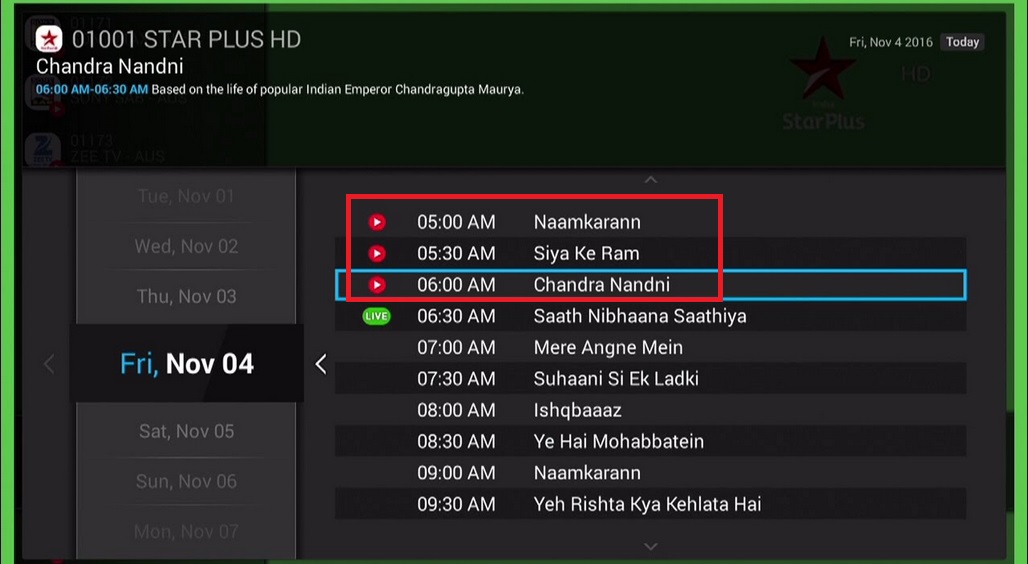

    - I can no longer access the replay by pressing directly on the right key (with the arrows) something I could do with MyTV online 1.
    Unclear from where you are trying to access replay from. You need to be more descriptive. No one can read your mind.
  • Hi ,
    Thanks for your answer:
    concerning: Unclear from where you are trying to access replay from. You need to be more descriptive. No one can read your mind.
    With "my tvonline 1", When I clicked on the button "See image formuler remote", I could see the list of programs available in replay as showed in the image "Formuler".
    Not possible with mytv online2.
