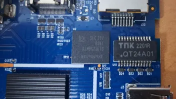

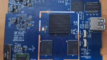

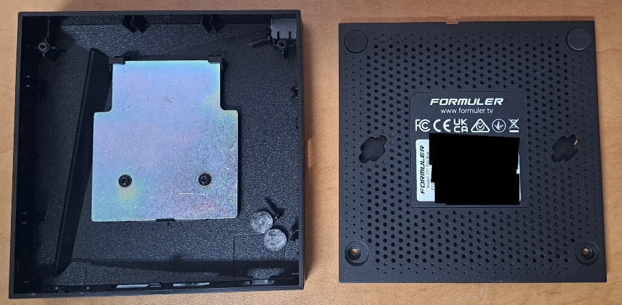

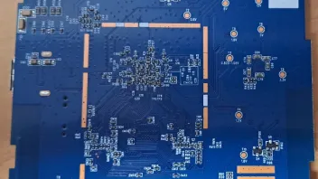

i should sent it also back for warranty.
This box is a 2023,work 1 year half. I have extend warranty on it via mastercard. I wait news from him... For now this box is only good for trash. If is there a way to JTAG the box with the good software and files i will do it. I found many explain for other old box,but not for this one...
I dont think you did a good job;you just lost any warranty you might still have by opening the box,btw as an atecnical nitwit i dont see the point you want to make,maybe you can explain in simple terms and how it relates to the issues you were having?

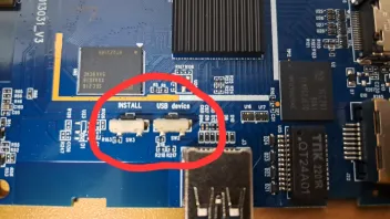

I try the 2 switchs without any result...my box was brick on RED light anf Flash every 20-30 secs. No picture on tv. When i plug the power the box light start RED without delay...no formuler logo. The box die when i take the last beta sofware...start picture freeze,no remote answer,no reboot,the box turn red light and stay at this state.
Hi, if you want to check under the hood...
Two interesting switch, INSTALL and USB. The same switch than the reset. Remove the 2 rubber feet,unscrew,open the box!
