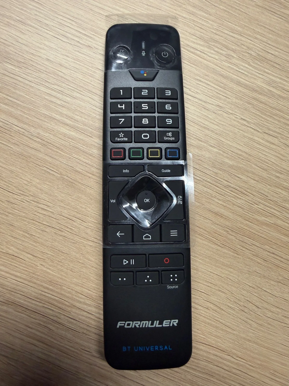

    Goodday, yet i catch the remote what lay on my table.
    Pushed the on/off button in of tv and didn't work.
    I clap on the back of remote 2 times and pushed again on on/off button and tv goes on.
    Strange. Batteries are good in remote. Worked whole day long. Only sometimes at evening not and in morning. 2 ticks on the back and it works?
    Will try it next time again, if it's help again then i place a piece of paper in it or so.
    But last time i did it too ticking on the back and won't worked then i thought. Ik keep trying.
    Changed to solved already. If it appears again and ticking helps. I let status solved.

    Try new Battery`s (good one) like Bazooka recommended, someone wrote on forum when his Battery`s going lower then 70% the RCU react strange. Of course it is strange and should not happen at all but good to test from your side and give us feedback.
    Will search and buy them.
    Thanks for info.
    But if you see in movie, battery out and in and it works again:thinking_face:

    Hello, I haven’t had any restarts since my last message but a new problem occurred. Three days ago, when I was about to go to sleep, I turned off the TV using the TV remote, and when I tried to turn off the Z12 with its remote, nothing happened. I turned the TV back on, but it was as if I had unplugged the HDMI cable from the Z12. I had to unplug the power to return to normal operation.
    Today, with the Z12 turned off, I tried to turn it on with the remote, but nothing worked again. Similarly, I had to unplug and plug the power back in to restore normal operation.
    Try next time if your tv and box won't start, take out battery from remote and put it back in. Try again if box and tv goes on. I have something similar that after some time side volume not work and or tv cannot power on by formuler remote.
    When i take off one battery, and put it back in remote it works again?
    See: RE: Z12 Remote won't work sometimes
    I would try new batteries 61% is on the low side, not sure if this would cause your problems though? Mines presently show 92% and not experiencing any issues whatsoever.
    A try worth yes, but it are the originals and 61% is enough I think. Younsee on movie that when i take out one battery and put it back everything works again?
    But will try new alkaline batteries. Will get them next week.
    Goodday my friends.
    Every day it happens that my remote is not working, mostly in evening after diner when i watch downloaded movie the side ir-volume buttons and in the evening or morning box on/off button sometimes. (See attached movie)
    What did i do already:
    Backlight set to: off
    Hdmi cec on box and tv are OFF (i don't use it never)
    6 times reset the remote with ok and 0 button. And set it up again. Then it works again. But it keeps happening every day.
    Batteries out for 10 minutes. And then plugged in again.
    Disconnect and connected with bluetooth couple of times (Have no other bluetooth devices here, yes my phone, but bluetoot off)
    Or i can simply do take one battery out and plug it in and then it works again the ir-buttons. Batteries in remote make connection, otherwise led will not blinking. (Before i take one out)
    (See attached movie when i try to put tv on.)
    I can use box, i see white led blinking from the bluetooth on remote. But sometimes that also won't work later the day. It blinks white, but reacts not on box. (Very rare, 1 time a week)
    Battery in and out and works again.
    It are the new batteries delivered with the box. 61% full.
