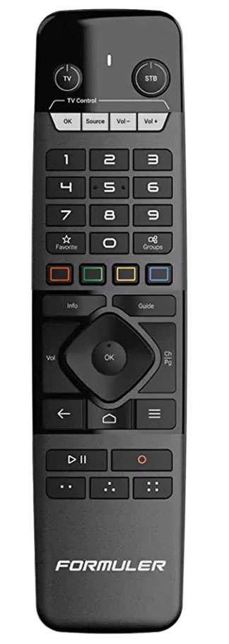

when I press that button (with three lines) nothing happens, the remote control led is blinking the z11 front led is also blinking, but no menu?
where is the menu button on the z11 remote?
I have recently updated from a Z8 to a Z11 Pro Max. I cannot find the menu to setup a connection. On the Z8 there is a menu button on the remote which leads me to the connections. On the Z11 there is no menu button on the remote only a settings button on the home page, with no connections menu.
How do I find the connections menu?
Will a Formuler Z11 Pro Max remote control work on a Formuler Z8?
Remote on the Z11 looks so much better and easier to use.
