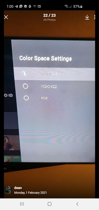

Dosent even give me a option to turn on or off on colour depth setting
As for hdmi cables im using the best about cost more than the gtv audioquest cinnamon i have swapped cinnamon cables from other rooms to make sure
Display More
The HDMI shake (exchange data) between box and TV decide what is possible and what not. It is also very curios that your second TV (curved) shows only one possible setting, should at least show RGB too.
Test following:
Auto switch to best resolution: activate
Colour Depth Setting: ON
Reboot your box after this and restart your TV.
Colour Depth Settings: -> How much are now shown?
Test also with other HDMI 2.0 cable and check your TV depth colour settings.
You think two different tvs with different specifications must give you the same color space options?
No but was curious why one only had one setting the others had 3 as sam said I should have at least RGB aswell which I don't have
thats two tvs hdmi cable
Both 4k just seems strange to me one box has one setting the other more options,
Is that the gtv detecting something different on one tv and giving more options 🤔

Mines perfect now
Nightmare when you having issues I couldn't watch it me if I had to wait that long hope it gets resolved for you
I had this problem myself when changing channels didn't have to wait that long with black screen thou this fixed my back screen when changing channels
Player options turn A.F.R. off
Go to settings
Display
Screen resolution turn off
Colour depth turn off
Colour space settings YxbCr420
Hdr to sdr auto
Sdr to hdr on
Worked for me
