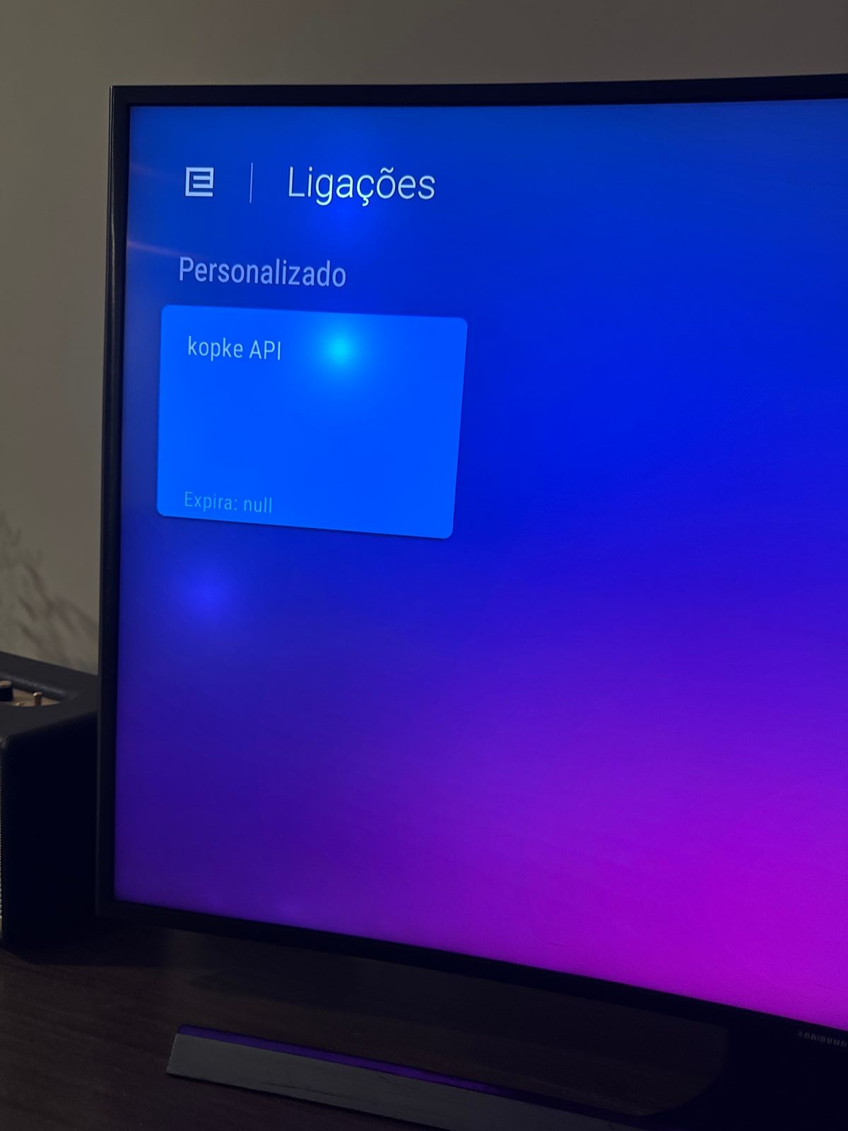

    But this time something different happened. As soon as MyTVonline2 was installed, the app opened in the connections menu and there was no "Add Portal" option. Just a "kopke API" folder as shown in the attached picture, that when selected asks me for a user and password I don't know what are. I tried so many things already (force stop mytvonline2, erase data and cache, taking out the power cable and turn it back on pressing the red button on the remote, putting on the 0227 code on the update page to the beta, nothing works).

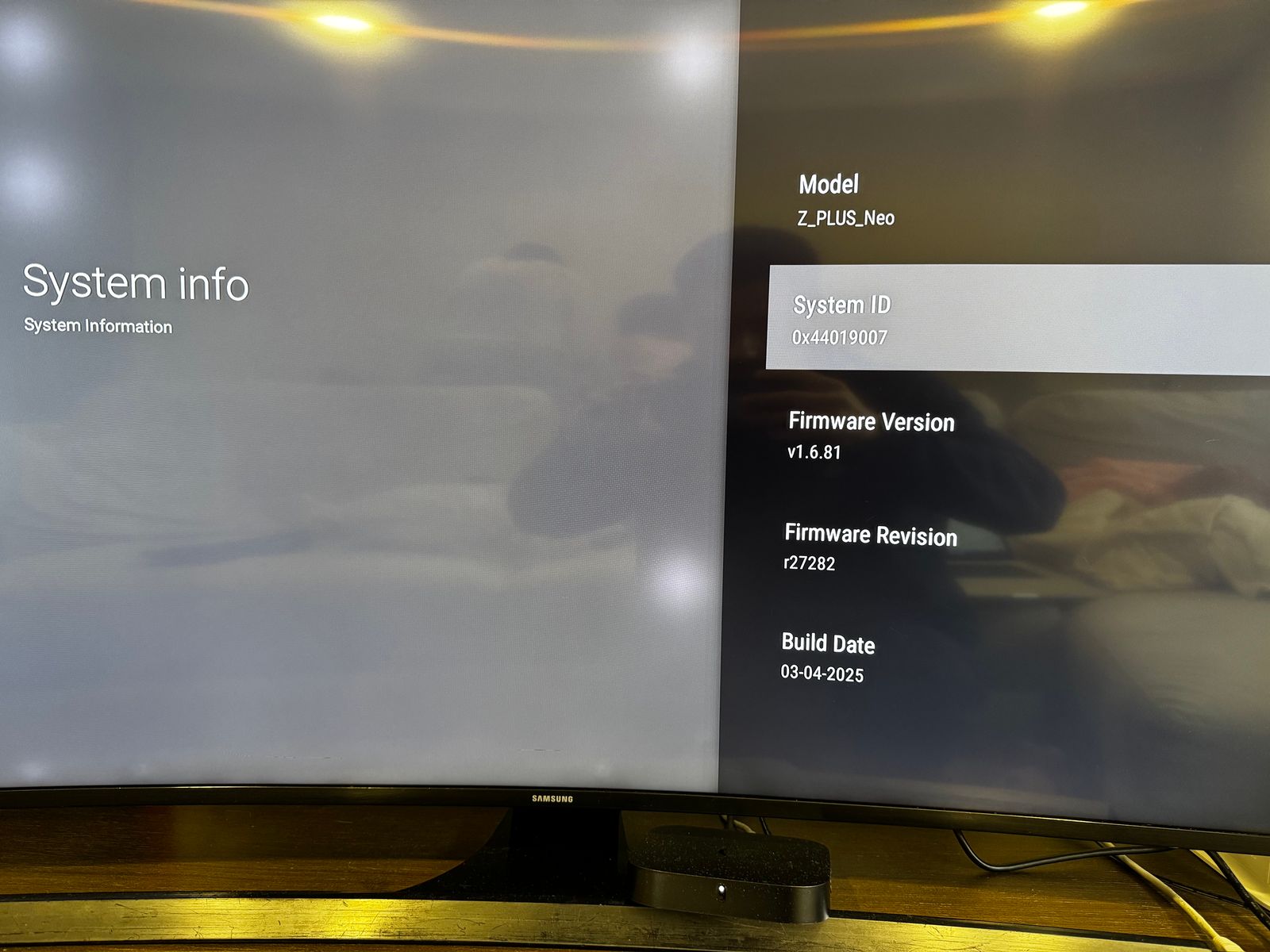

  • Nothing happens, on system info this is what i have. The vendor couldn't block my box, I already did factory default reset many times before and this never happened.

  • That's it, since the factory reset I can't add a new portal, in the first image I posted I show the screen where I used to add new portals with credentials. But now there is nothing but a portal called "kopke API" to which I don't know the user and password (I tried my subscrition credential but it didn't work, of course).
  • Ok, this one I could find and it factory reset the device when I pressed 0 x10 times.
    And the problem IS SOLVED!!!!
    Thank you so much, Lucky13 and henkie for your help. I was going mad with this, you guys are the best!!!
