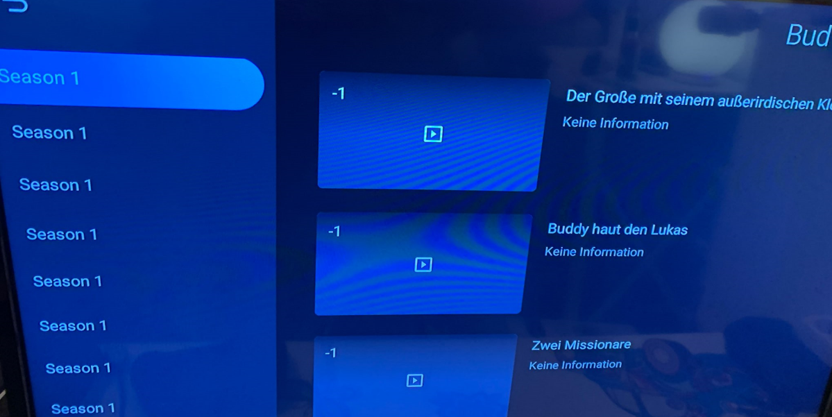

    We do not use XC or XCUI as a panel, but another panel with working stalker support. We currently have the problem with the z8 that VOD films are categorized directly under series and are not available.
    As soon as I open the Bud Spencer VOD package, for example, I see all films staggered as series episodes.

    He managed to Log the Requests from MTVO2.
    first request : /c/player_api.php?username=&password=...
    second request GET /c which is not meant to be requested.
    Code
    the main thing is that their app does 2 or 3 request and when responses received the same app work internally to grab data may be by m3u or whatever
    MTVO1 works fine with the Panel like it should be and like M*G. I think you know the difference.
