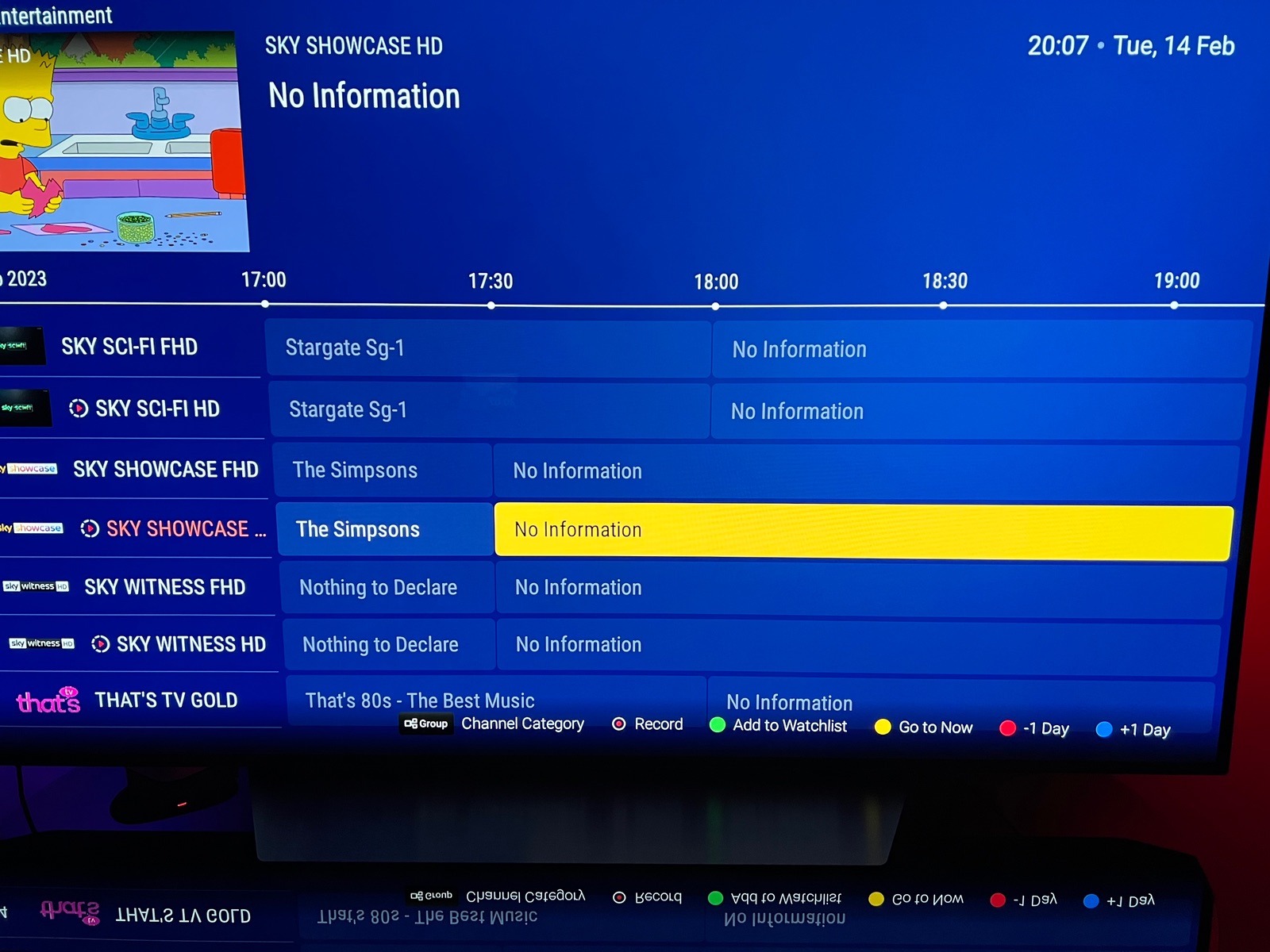

  • In the first epg guide below it shows all future programmes from today the 14th until the 20th correctly,but in the recording guide it will only show the 14th and 15th with working epg then it says no information,I've tried the usall in reloading the epg and rebooting but didn't help
  • I have exactly the same problem,recording epg for 24 hours,whereas single epg for 7 days.I did not have this problem with my z10pro only with my Z11promax.

    I'm in the UK,my provider is in the UK,this is definitely 100% a formuler issue as I have tivimate installed on my z11 aswell and the epg works correctly

  • All together it is clear that lots of us are experiencing EPG problems or actually IPG.
    Also striking that all the problems have similarities but also differences.
    Because of this it probably is a combination between Z11 pro max but also the difference in providers causing the diverse problems.
    In my caseI can see programs appearing in the guide but only 2 to 4 hours ahead or back.
    This is different per channel.
    In the EPG function per channel I can go forward and back 7 days like I have selected in my settings but catch-up broadcast can only go back about 2 days and 3 hours.
    I do not know how a EPG should work but when I see the option in settings where you can clear and refresh the EPG I suppose the information is gathered and stored.....then refreshed after 5 hours.
    In my case I do not have the impression EPG data are stored.
    When I change groups I can see the information starting to come slowly. So changing from no information to the program information. This also happens during scrolling through the guide.
    So to me it looks like EPG data is not stored properly or not stored at all or reload endlessly....like some kind of loop.
    I hope my experience can help formuler to solve this.
    I do have confidence they are working on this but if this is only a European problem I do not know if it will have their full attention.
    A note from their site saying they are working on it would be very much appreciated.

    I don't believe there are so few reports. The whole forum is full of EPG problems. The problems are caused by a combination of provider server time, time zone and EPG offset. TiviMate managed to get this working, so I hope MYTVOnline will succeed as well.

    For the EPG issues, I don't think it has to do with the provider, but surely, the combination of time zone, date/time and EPG offset are causing problems.
    As you say, TiViMate works perfect. When setting the box to automatic and time zone to GMT+1 and EPG offset -01:00 (for all countries in this time zone), it give correct EPG info on all levels. Only TiViMate is not free, you need to pay for it (€ 10,99/year or € 33,99 for life).

  • I also have problems with the EPG.
    The texts are present, but not in accordance with the schedule.
    To have the right EPG at the right time, I also have to change the time zone.
    In order to test if it's a problem with MYTV online 3 I installed IPTV Smarters Pro using the same IPTV access provider, and setting the time zone correctly, and there the EPG works correctly.

    Formuler is aware of this EPG Issue and will implement an option soon to improve this issue for sure.
    It looks like some servers can't cope with the new requirements of MOL3. That's why some things in the MOL3 EPG area will be optimized down to MOL2 level.
    No need for new reports in this case, it is known and devs. will work on it. Please be patinate and await the fix. If the fix not come with next official version it will come for sure with update after.
