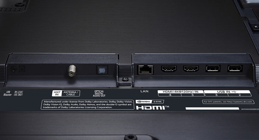

    Connect z11 pro to hdmi 4! It supports 4k@120hz
    3 and 4 on my lg are hdmi 2.2 and arc. And supports 4k@120hz.
    Hdmi 1 and 2 not.
    I find it out 2 years back. Hdmi 4 is my z11 pro max, hdmi 3 is my xbox and hdmi 2 is my raspberry pi.
    See added photo as example!
    Go on lg tv to settings, then search at system devices or so and then turn off hdmi cec.
