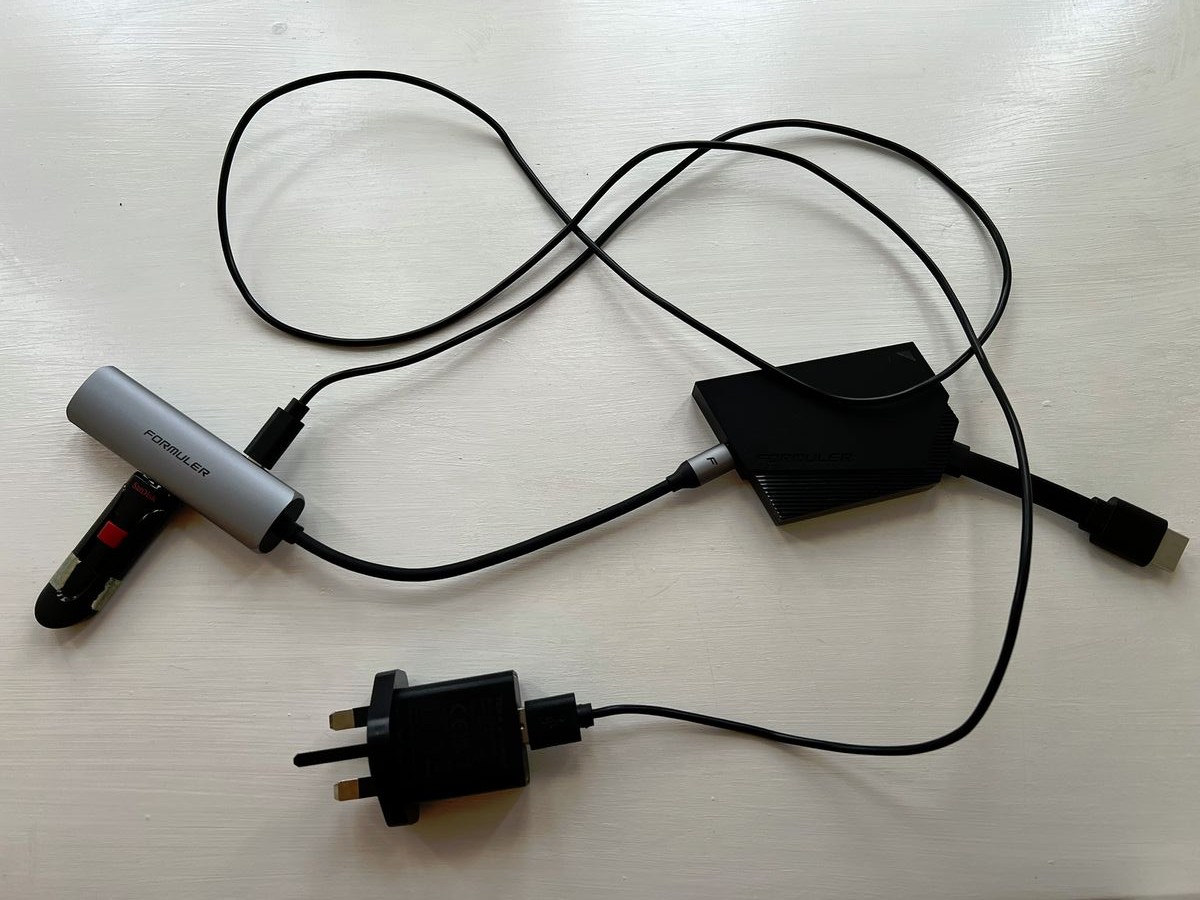

I received Formuler USB-C Hub this morning.
I have 2 ScanDisk USB stick.
I tried to installed ProtonVPN apk (TV android & TV f-droid (type types)) on Z Mini using Formuler USB-C Hub. Nothing is happening, file is not recognizing from the two usb stick.
Also
Gear > Settings > Device Preference Storage - under "Removable Storage" - message flickering between "ScanDisk Safely rejected" and "ESD-USB is safely rejected" This is even when the ScanDisk is in the USB hub.
I have no other apps installed. I reads "1.6GB of 5.6GB used" (can't remember exact figures). So I have enough memory, right?

I have attched picture how I set it up, let me know if it should be different.
Does the mediabrower the right? I don't know, it is how I recieved it.
I have formatted usb to ntfs. I have done this few times since you advised.
Google PlayStore does not allow me install anything. Complaining device does not have enough storage.
I have done the cache files removal number of times.
Could factory reset be needed or something wrong with USB stick?
Your config is ok.
