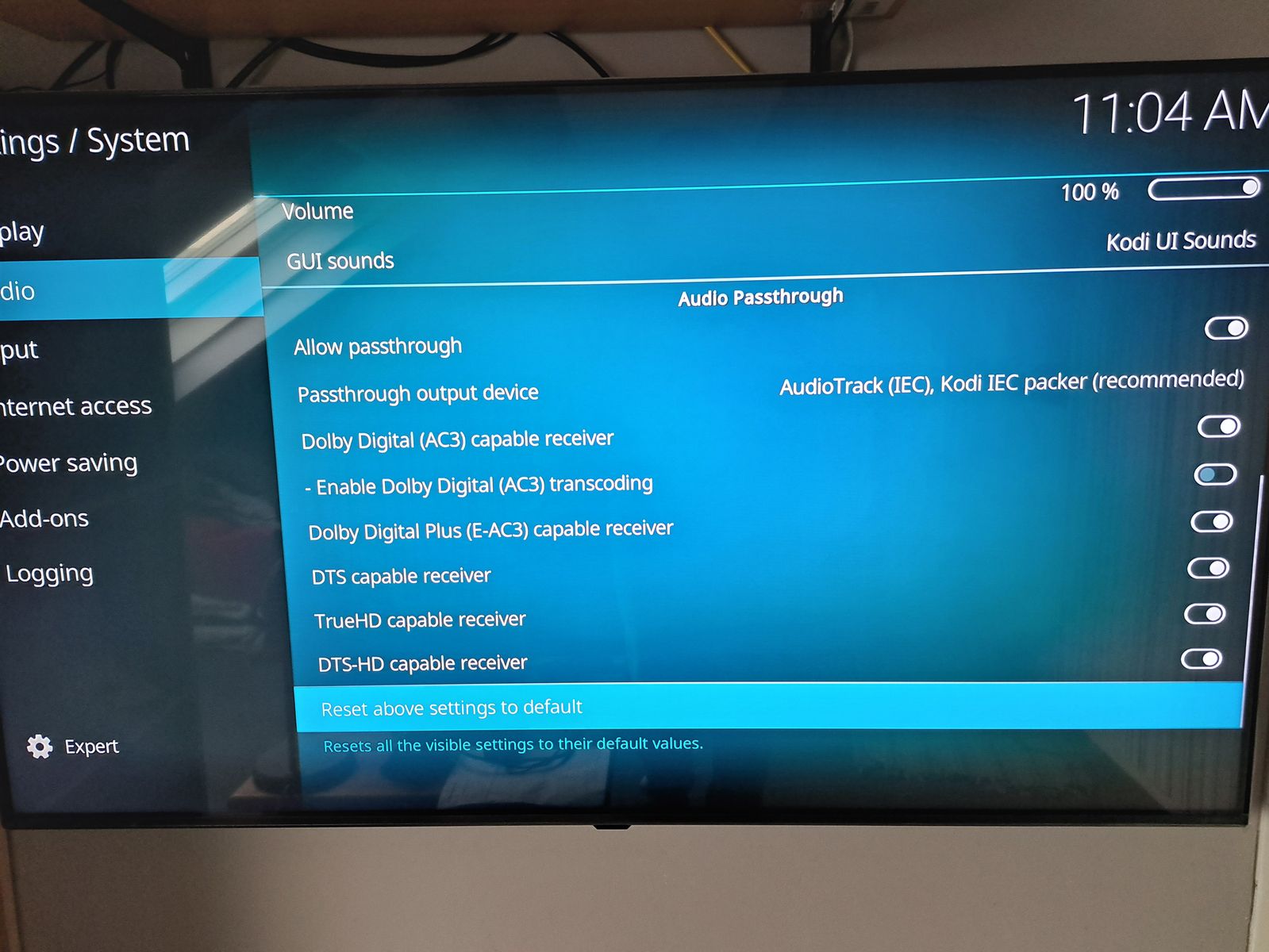

Hello, i have a Formuler Z11 Pro connected to a Yamaha AVR there the TV is connected to as well. I get 5.1 audio from MOL3 but not from Kodi, and i have passthrough enabled in Kodi. And i have run the Audio Optimizer ro. Anyone with same issues? Best regards Thore from Sweden
Only 5.1 from MOL3 not from Kodi.

I kodi options you can change on the left side the options to expert.
And then in settings at system section switch under passthrough the switches on. Only one needs to be off!

Exactly, but i wrote that i have done that so the question is why i have 5.1 via MOL3 and not from Kodi? Thanks for your reply.

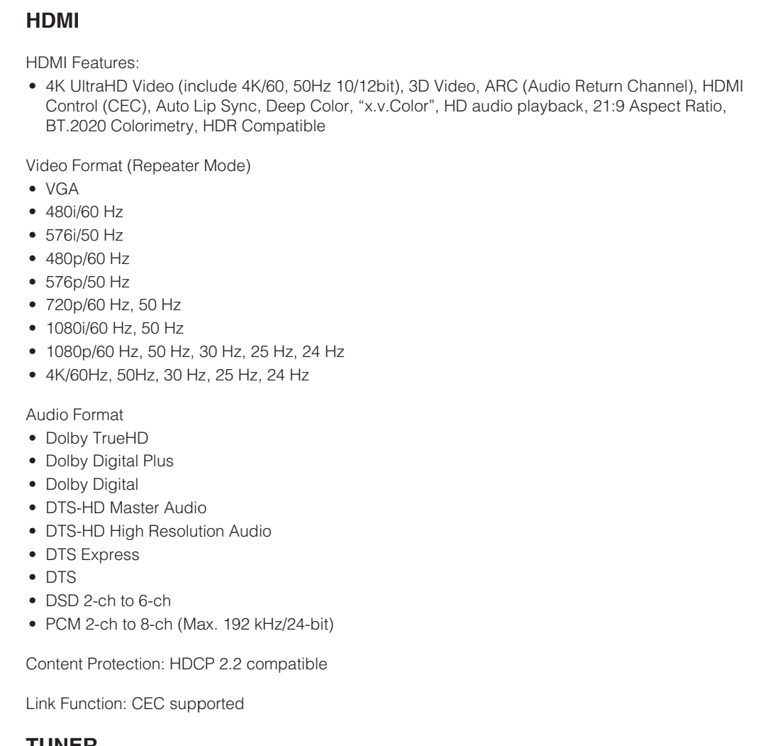

Can your avr play dts?
Is your avr connected with a hdmi cable? Hdmi let's dts thrue.
If your avr is connected with a optical cable it's logical. Dts can only via hdmi if avr supported.
Not via a optical cable. That can max dolby 5.1 passthrough so far i know.

Hello again, yes it can. I attache a picture of what it can play. And what i know there is no optical connection on the Formuler Z11 Pro. My stuff is connected like this: Formuler->AVR->tv all with HDMI cables that comes with the products.
Great audio support! Cool!
