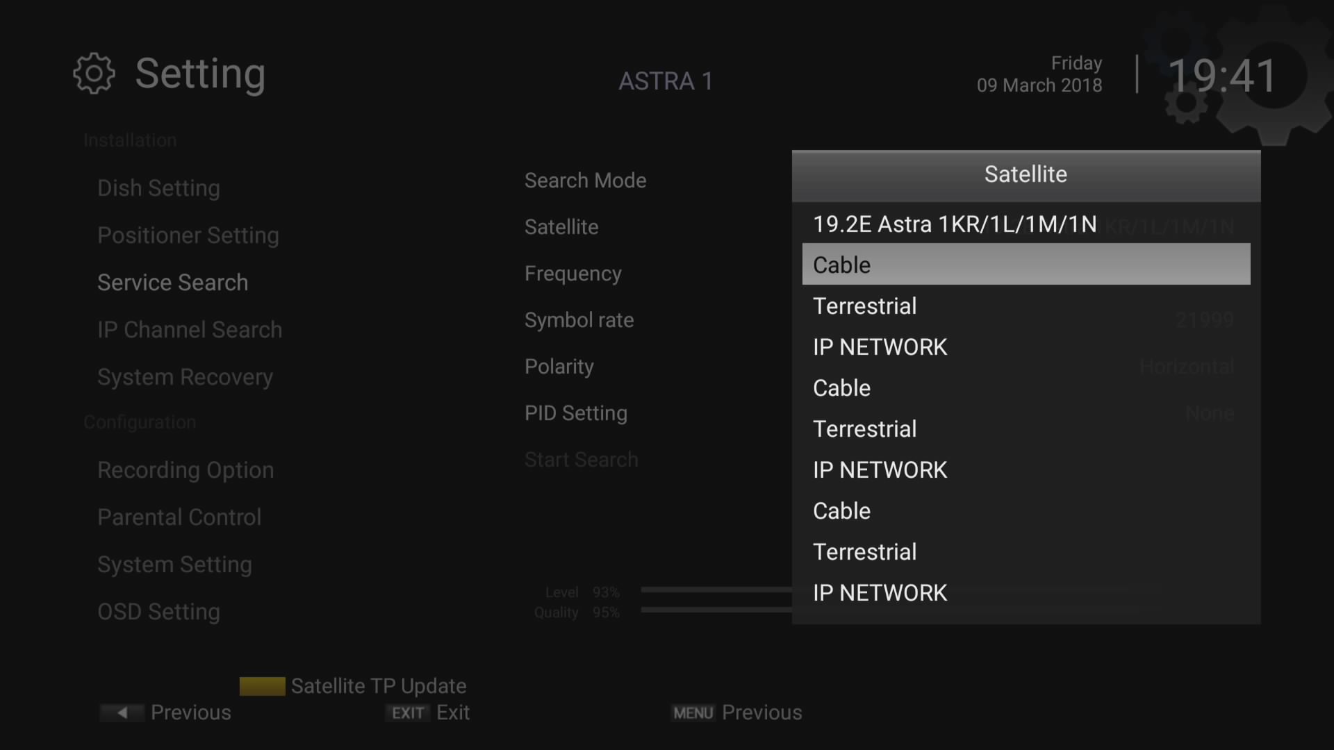

Hi Tahir2007pk,
please do like follow:

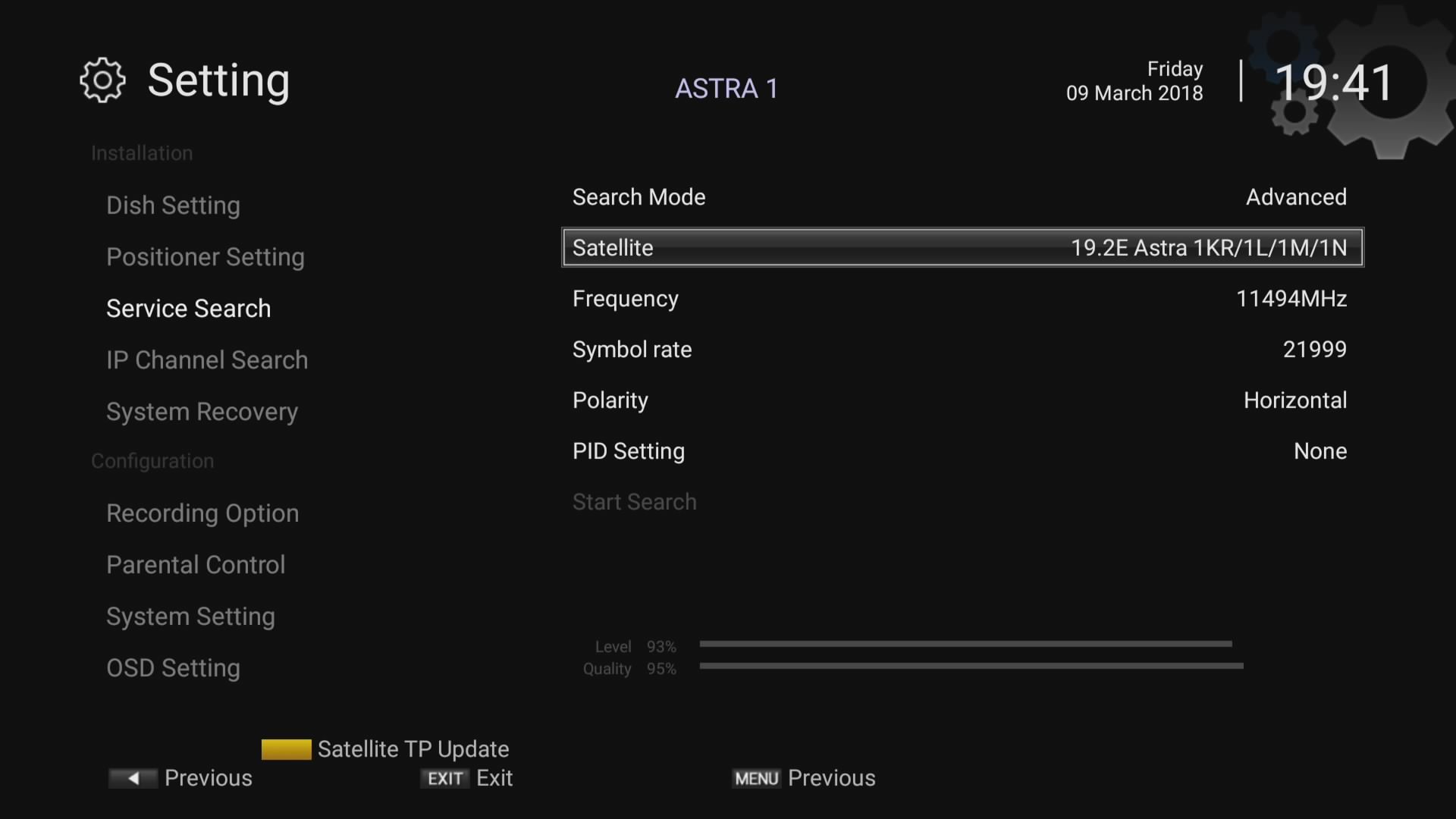

Menu -> DVB -> [lexicon]Settings[/lexicon] -> Service Search -> Search Mode "Advanced" and under Satellite press and chose Cable and start search. See pictures.
i tried as you said but i donot see cable in satellite list all i see is user1 user2 user3 only there is no option of cable or tereestrial or ip network in drop down menu only satellite list user1, 2 so on
FW Nb. from your Box? You can see it under Menu -> DVB -> System
Last Update fw nb. is 1.6.0 -
Yes I have the latest version 1.60 but there is no option of either cable or terrestrial in channel search thanks for your help
