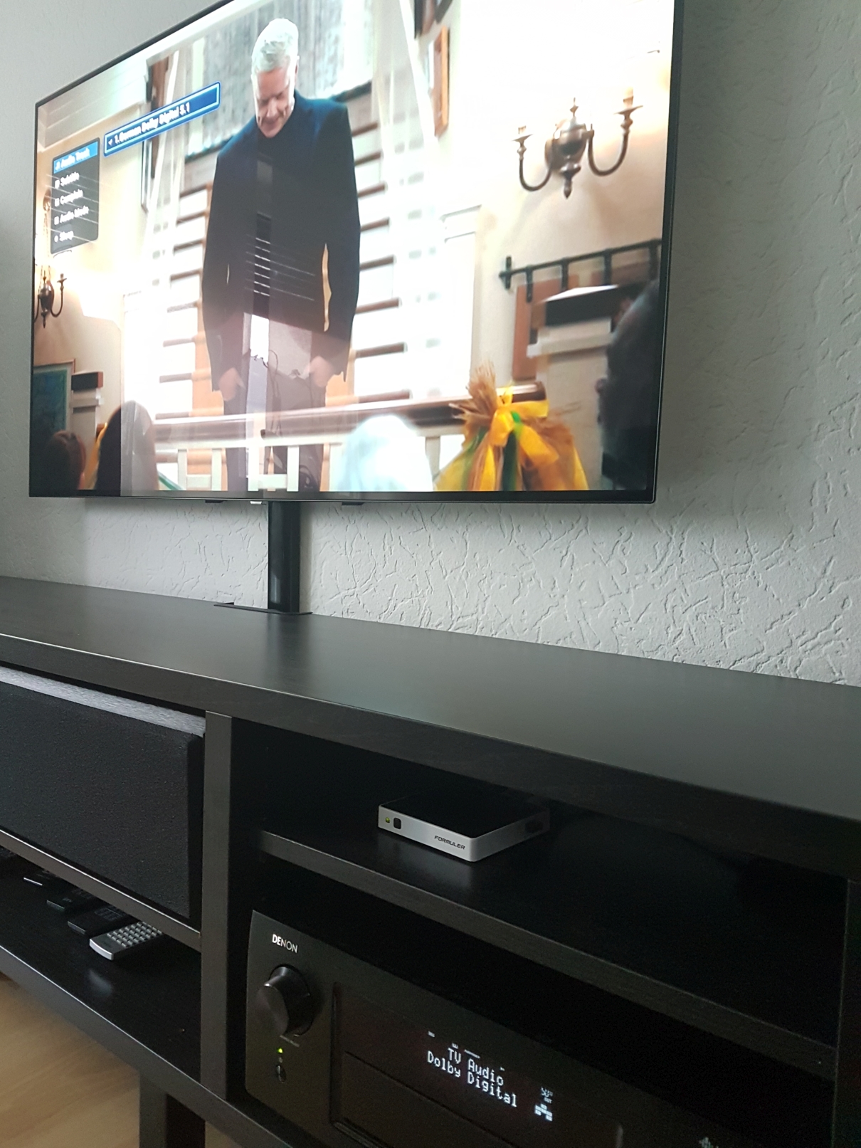

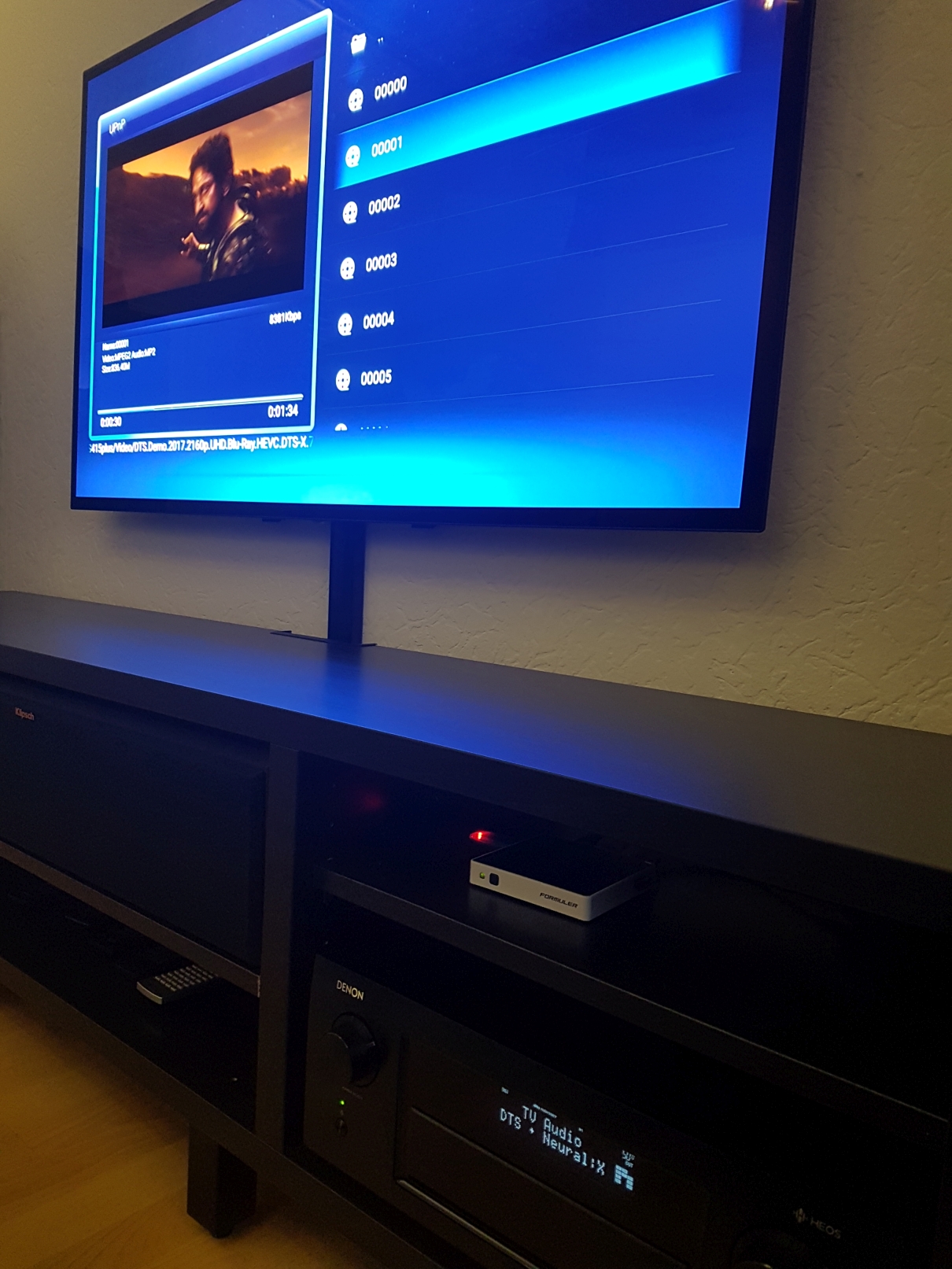

Here also one picture with MYTVONline in 5.1 DD and second picture from NAS trough Mediacenter and Audio format DTS shown on AVR Display.
For this how to is the Box directly connected to TV with HDMI and TV trough optical cable and HDMI(ARC) to AVR.
