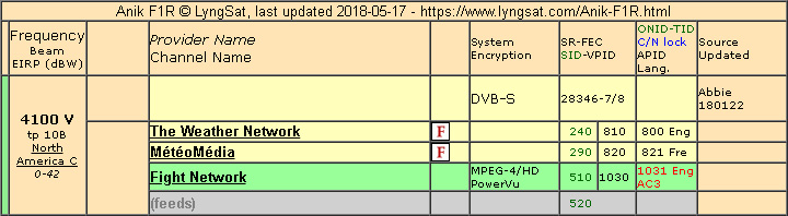

    The problem now is how can I set the DVB-S receiver to tune a North American satellite (Anik F1R). Specifically to our (unscrambled) feed in one of the transponders (tp 10B)... attached infor of the satellite from lyngsat.

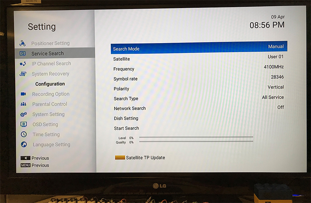

    I've tried manually entering the data but I get no luck (attached screen shot of the settings). Are these box good for this task? Maybe I'm missing something... hope you can help me out.

    - For testing purposes I could use any other transponder; for the final use the need wil be to use "4100V TP10B" as shown in the Lyngsat page

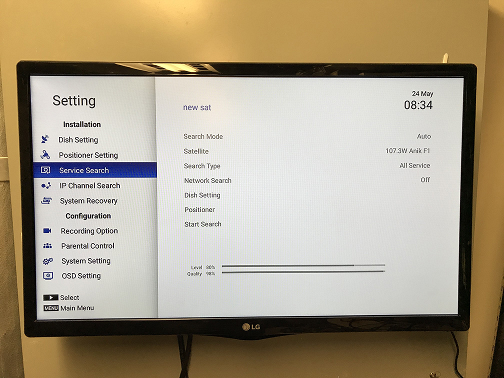

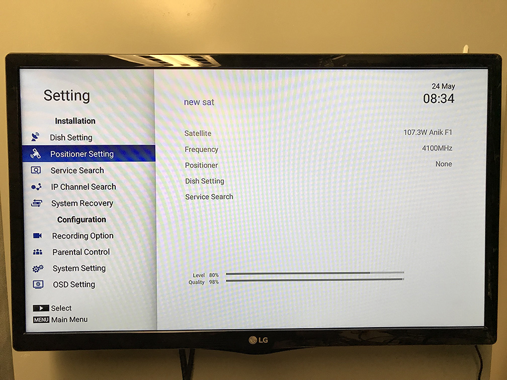

    Second: I GOT IT WORKING!!

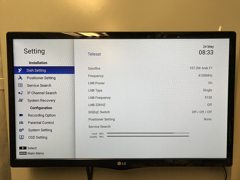

    The problem I was having is that the setting info I was using was incorrect. After a little bit of self teach (on how the interface present the information) and thanks to Google I understand the culprit was forth the "Frequency" and the "LNB Frequency" settings. For the transponder I wanted (4100 V) the correct values are:
    Frequency: 4100 [V] 28346 >> Which gets taken care by updating the TP list but ONLY if the next setting is correct!
    LNB Frequency: 5150.
    Once these two values were set (I had to manually add the TP) the "Quality" bar showed signal. Then I was able to update the LB list and scan the channels.
    In short, I know the oscillation frequency is dependent of the band and frequency of the transponder to reach... I just had to translate the concepts and put them all together. See attached the three screens of the system working.
