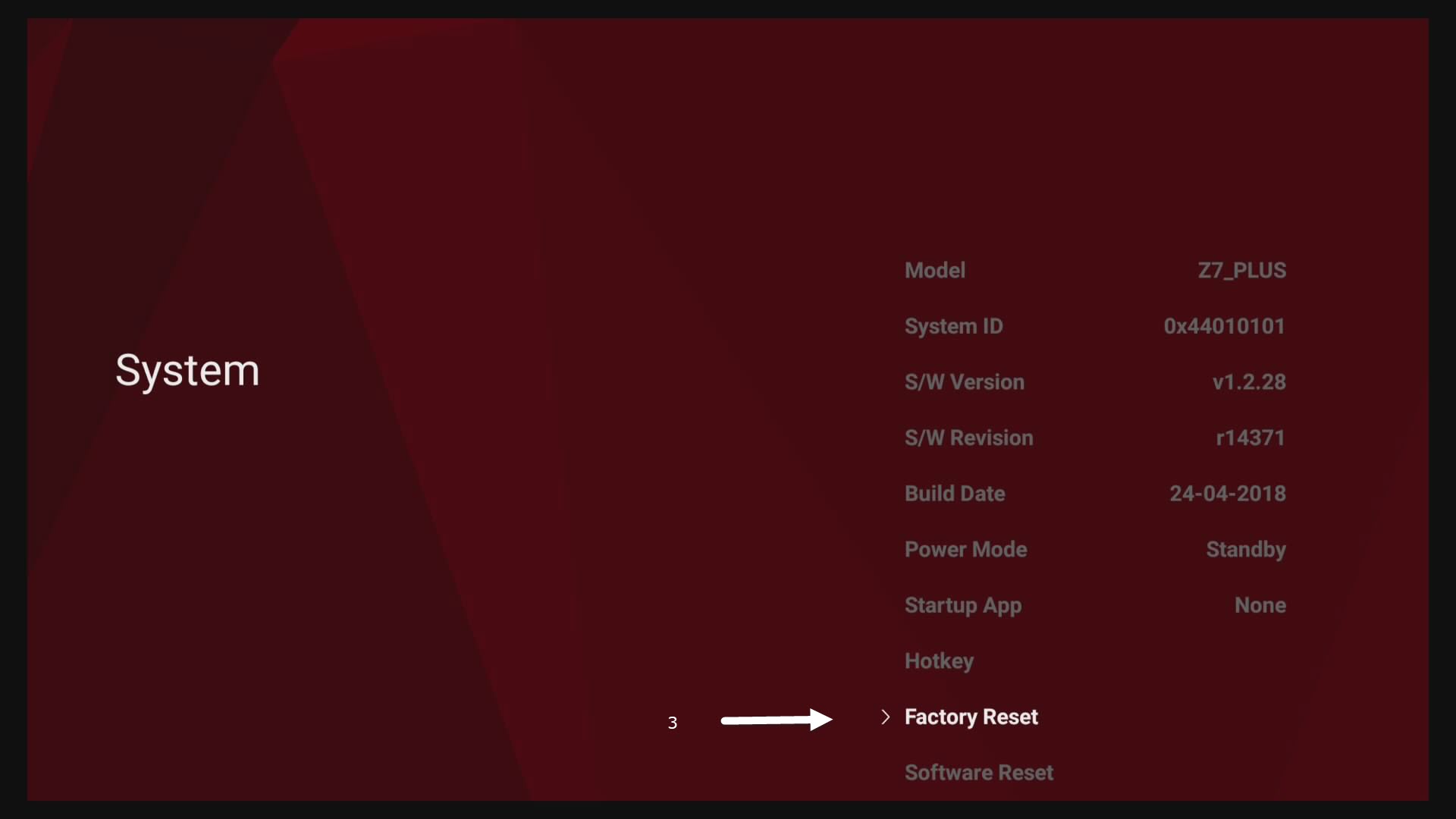

    I would suggest do factory reset first, install latest MYTVOnline and make all settings again. Please see attached pictures.
    1. Unplug first all USB devices and go to "System" and do factory reset (picture 1,2 and 3). Reboot the box.
    2. After factory reset should come MYTVOnline update, if this not appear, please go again to the last menu but this time use icon "update". If there are firmware updates to be done, please install firmware updates first. At end install the latest 1.9.35 MYTVonline. Box will restart.
    3. Make all needed settings under Android and MYTVOnline.
