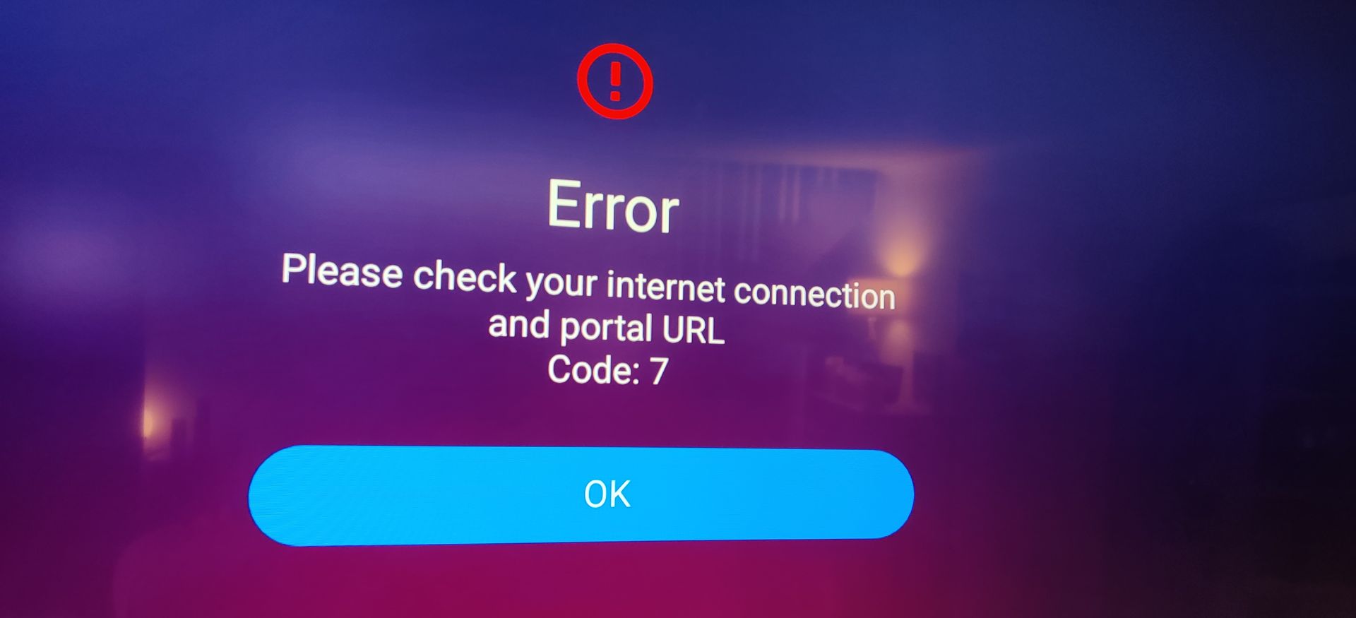

It all worked fine before the update but it's been intermittent and now just no connection.
Can't connect to my portal anymore since update

following this topic cas have the same issue & my connection is good just cant connect portals says same error as poster.
Formula must know this issue surely.
Same problem here. Was watching and all was well, did the update and get the error 7 message on the z8.
Got a new z8 out and tried to activate it but same error 7 message also.
Same problem here
Ok guys, I fixed my issue...
my vpn expired last week and z8 was running fine without it. After update, I got the dreaded code 7. My internet provider was blocking me.. re established Nord and it loaded right up and everything has been good for over an hour.. Hope this helps

mine still wont work with Mol2 ??? with or without Nord.
After I got Nord back running, I did a factory reset and then reloaded everything. It took about 2 minutes of scrolling at 10% then it loaded completely.
I have logged off and on again and it still takes a couple minutes to reload.
mine is doing the same thing after upgrade, doing a factory reset now with vpn still nothing im at my wits end still code 7 your account is blocked have contacted service provider and he told me to do factory reset or by new unit everything ok on his side whats next up for replies
The problem was my provider but there really is a big problem with this last update. Lots of crashing. It’s pretty tough dealing with multiple layers of possible screw ups.

Formular z8 unit, portal url on my mol2 will not load still getting a code 7, purchased new different iptv provider program, did all the resets and reloads possible checked with ISP provider all open on my account, checked with IPTV provider all good on both suppliers. loaded M3u playlist programming and all works on MOL2 but portal settings are still is code 7. so issue is with MOL2 portals need suggestions to fix issue
