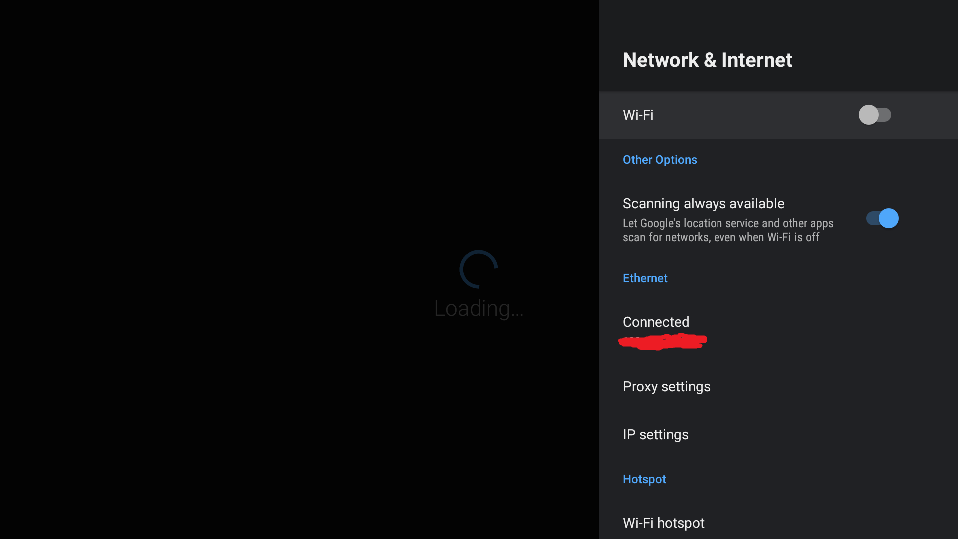

Hello all! Dear people who can check and confirm? The thing is that when I installed the playmarket FTA Tuner Loader and Live Channel then plugged into a jack 3.0 MyGiga stick, I lost WiFi network and then it can not turn on.
It connects via LAN cable without any problems.

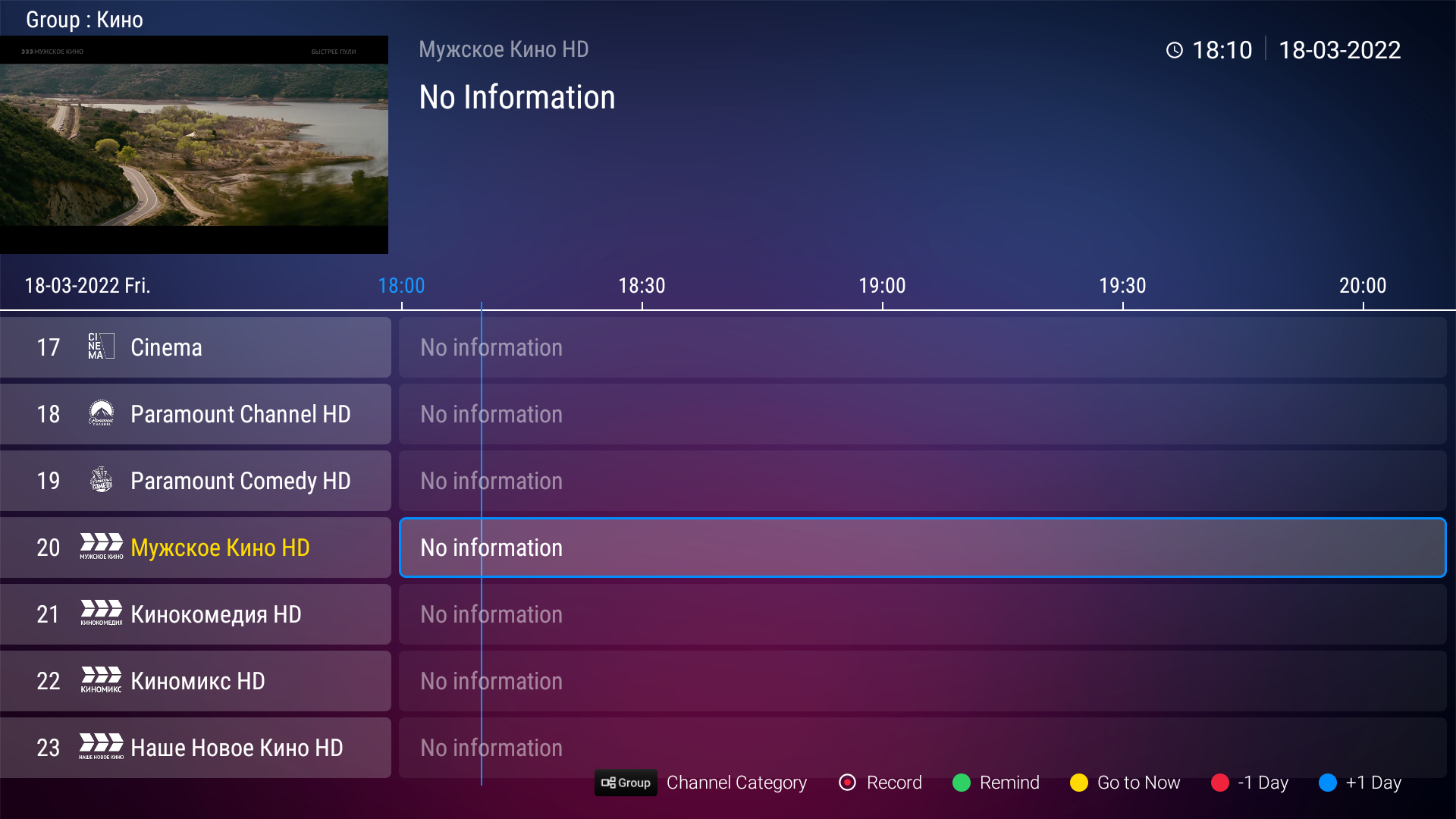

For me, the top priority in MOL2 is to support
Minist protocol... Before version 5.6.0 and epg which that don't work...
Note what is stated in MOL2, the formats are epg gz, zip and xml and none of them work.

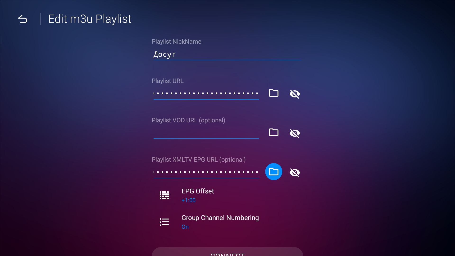

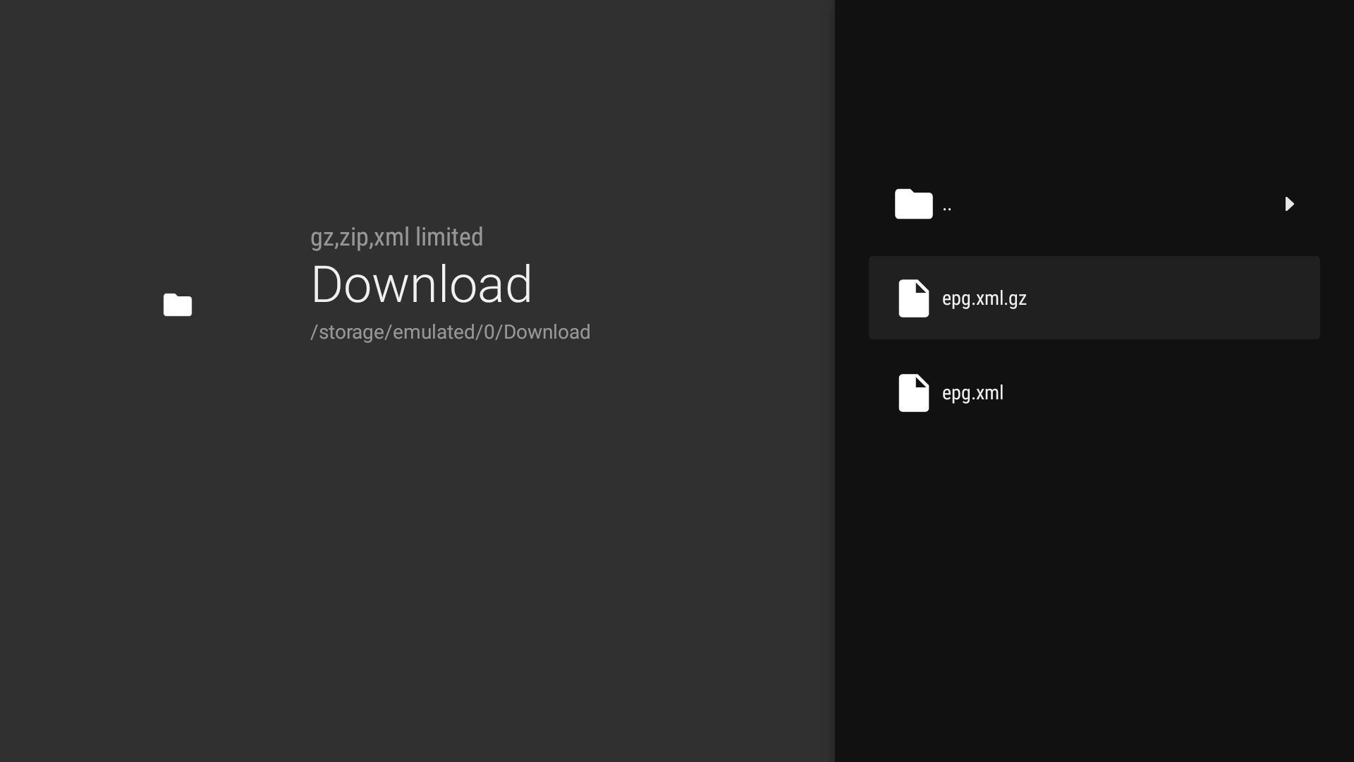

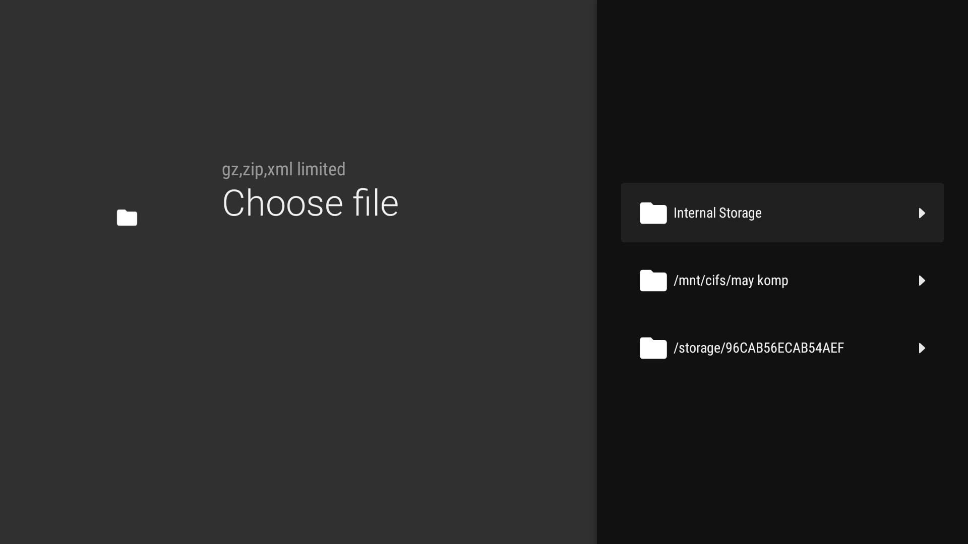

Not one epg from the link does not work for me. Although I have already tried more than 10 providers. If you download the file and enter it starts working.
