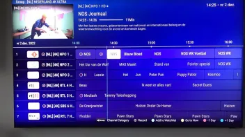

I have tried everything, delete and load m3u line again, go back to factory settings etc. but nothing helps.
EPG Guide shows correct info but in the channel list there is no info at all (see attachments).Testing with other app, SmartOne-IPTV, shows all channel info correctly.
Conclusion, this is a bug in MOL3.
Pls solve, as this is very annoying.Thanks

The only workaround, which now is working for me (location the Netherlands), is as follow;
In the main settings (thus not in MOL3) go to Device Preferences and than to Date and Time.
Set the time zone to "GMT+00:00 Greenwich Mean Time" (Thus not (Amsterdam, Brussels, Berlin etc.).
Set Automatic date & time: "Off", and set your time manualy to the correct time of your location.
After that go to the "Content Manager" in MOL3, and than set EPG Offset to "None".
Now the Channel list shows the information and also the EPG Guide has the correct info.
Hope this will help some of you too, with this problem.

On the Z11 pro max, the single epg view (channels) become no information when epg offset is set to -1
The multi view (guid) show the correct epg information

I get it to work by workaround
On the system i turn off the automatic time
and the time zone on GMT +00:00 coordinated world time
and the time itself i put it correctly to the time in this zone
then in MTVOnline i set the EPG offset to None
Now the correct EPG is shown at the guid en the single view and also the channels give correct EPG
This workaround also works for me. But it's not convenient, so the bug needs to be fixed.
