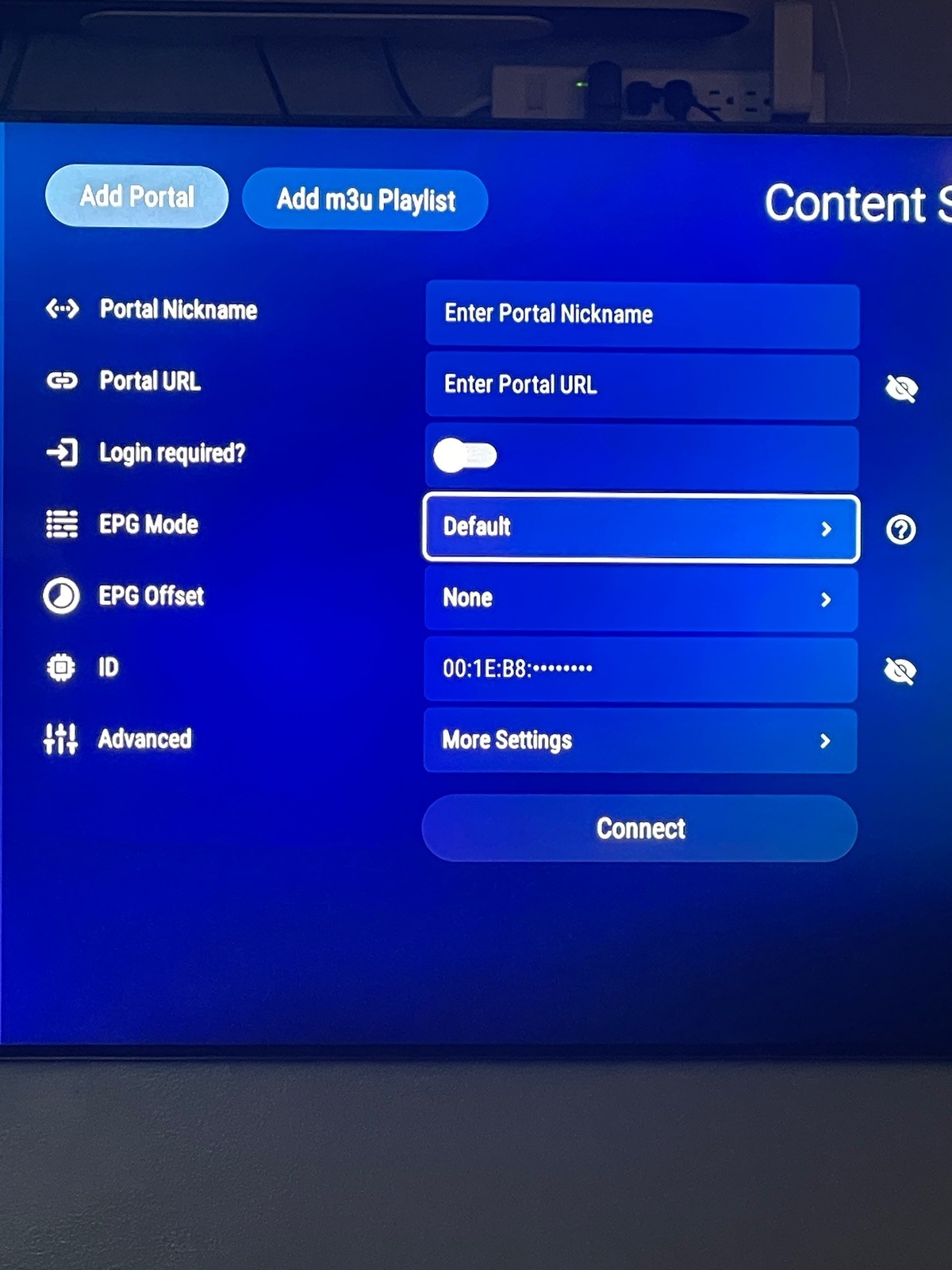

Finally figured this out. Apparently when you add a connection portal there is an epg mode option and changing it from normal to alternative works. Once you add the portal Connection there is no way to change it other than re-adding it. Formuler admins might need to add this option in
Where's this setting? I've resetted my device quite a few times and did everything from scratch, never noticed this setting before. But I'll take note of your proposed solution and check next time if I ever have do reinstall my portal.
I had to delete the portal and re-add it
It’s only there when you add it. See attachment
