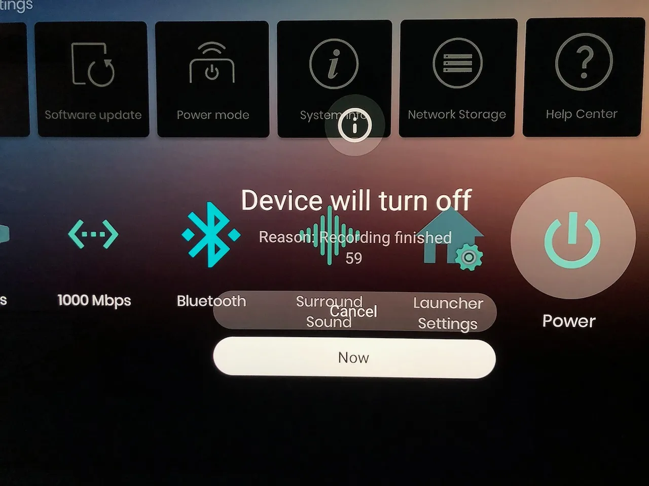

I have never seen a message like in your picture,i usually get a message "recording-name show- ended,in the right lower quadrant of the screen.If i see correctly on your picture there is a countdown (59) for the device to turn off or cancel /or turn off now.I have never seen any of these messages on my z11,whether when recording from power off or standby position!
This message appears after a scheduled recording. The box is in standby, it wakes up, makes the recording and after that it should return to standby (at least this is what MOL2/Z10 does).
The “59” thing should be a countdown but it is not. Instead of returning to standby the box just shows that message for an indefinite period of time (usually until you get back home, open your TV and choose the Z11 as video source).
This happen to some other user few weeks ago on German forum too, he done factory reset and since then no issues.
The factory reset “solution” occurs too often and in too many situations (in my opinion) for what should be a mature linux box (that’s what android ultimately is). I’ll try it but the next update should fix a lot of things (problems like the one above, recordings hit/miss, single channel epg not showing etc.). Anyway, thank you for the suggestion!
The reason why i recommended factory reset is only because you point to more then one issue. The Picture shows us shutdown countdown that has stuck, this could be some freeze process.

Well, I'll be darned... Either SAM you did something to it last night or it (the box) was scared when I told it I'd replace it back with the old Z10, but for the first time since I bought this box the scheduled recording worked AND it returned to standby when finished. I did literally nothing (no factory reset, the same **** generated m3u etc.) apart from writing this post. I don't know anymore what to make of this box... Of course, the single epg is still not working (maybe I'll have another talk with the Z11 about that :)) ) so I'll probably have to make the factory reset in the end, but what regards the return to standby after scheduled recording is obvious that the Z11/MOL3 knows how to do it, it just doesn't want (at least didn't until now, I'll have to see).

I have had that same screen popup but it happens randomly. Also wondering if you have issues recording with the BOSS edited playlist. I have 2 exact playlists the original is an xc playlist and then the same playlist edited in IPTVBoss and converted to m3u. I cannot record any progam using the m3u but i can record using xc playlist. Have you experienced this?
