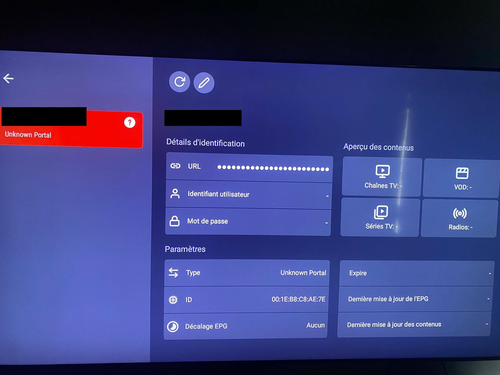

No option to add portal
    • Model: Formuler Z11 Pro Max
    • Retail Box or Provider Box: Retail Box I think
    • Firmware version: v11.3.5-r0xaea84bbe
    • MYTVOnline 3 version: 12.1.21-4557-b3486f28f
    • Connection with provider: M3U Playlist.
    • Box connected with: Wifi/Ethernet
    • Did you factory reset your device? and when?: yes 24 feb 2025
    • Picture url (only https):
    • Video download url (only https): none so far
    • What issue(s) are you having?
      Hi everyone,
      I bought a Formuler Z11 Pro Max last year from a reseller who did register me to a provider and did configure my device.
      My one year subscription is now over and unfortunately the reseller doesn't exist anymore.
      I started a new registration myself with that same provider so now I have my login password and URL info. I used them on a Formuler Z10 and it works fine.
      I now want to configure my Formuler Z11 Pro Max with these credentials, but it seems the reseller did lock the possibility to add new source.
      When in MyTVOnline3 I go to settings and sources, I have the portal configured by the reseller, but no option to add a new one.
      I did a factory reset on the formuler, I did uninstall and reinstall MyTVOnline3 but I still end up with that previous source and no option do add a new one.
      How can I fully get back to a "clean" install where I'll be able to add new source?
      If you need specific info I'll be more than happy to provide it :smiling_face:
      Thanks already for your help.
    • What was you expecting to happen? Being able to add the portal of my new provider
    • What happened instead? I don't have the option to add a new portal
    • How can we reproduce the issue you are having? I hope for you you won't have this issue :smiling_face:
    • What have you tried if anything to rectify the issue?
      - factory reset from the Formuler Settings
      - Uninstall / reinstall MyTVOnline3
      - install a previous version of MyTVOnline3

  • Thank you very much it worked !!!
    For people getting on this thread, here is the short version of the solution :
    - Go to the settings of the Formuler (not the MyTVOnline)
    - Go to System Information
    - Go down to the latest option in the menu (don't go in)
    - Press 10 times 0 on your remote control and the Formuler will start to fully reinstall.
    Thanks again woste
