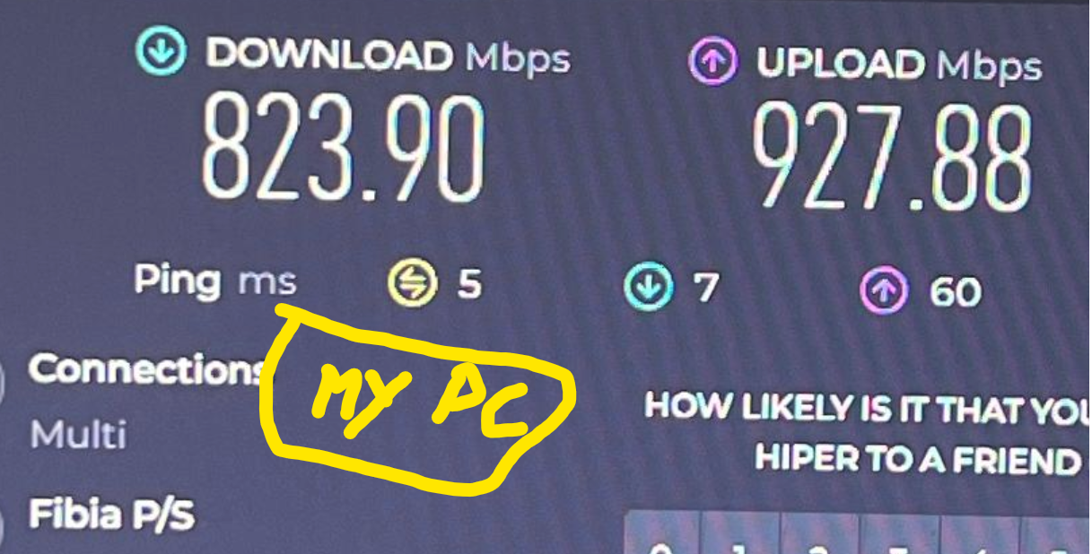

My problem is that my internet connection is very poor when I measure via my Formuler Z11 pro.
It fluctuates a lot but is often between 60 and 90mbps which means that I can't watch TV, especially there are channels where the sound and picture don't match.
I have a 1000mbps up and down connection and when I do the same test on my PC it is about 830mbps.
I have tried moving the Formula box all the way to the Router and putting in a new cable.
This didn't help. The problem is the same when it runs wireless. As I see it, there is a problem in the Formuler Box, but what ?
What can i do ?

After looking at your original post's photos again, it is remarkable that the upload speed on your Z11 Pro is measured at 702Mpbs which is close to the theoretical max speed. The download speed looks capped however.
Another insight is the ping to your speed test server on the Z11 is very bad: 285ms. This value should be sub-10ms or less than 50ms. Try to change the testing server location to one that is closer to you.

The ping is too high on the z11. Make sure you're not using any VPN on the Z11 when doing the test.
Check your network configuration on the Z11 or reset the network settings and try again.
I don't use VPN and have tried resetting all internet settings, nothing helped. It doesn't matter if I use cable or wifi, the speed doesn't change. Something is happening in the Box.
