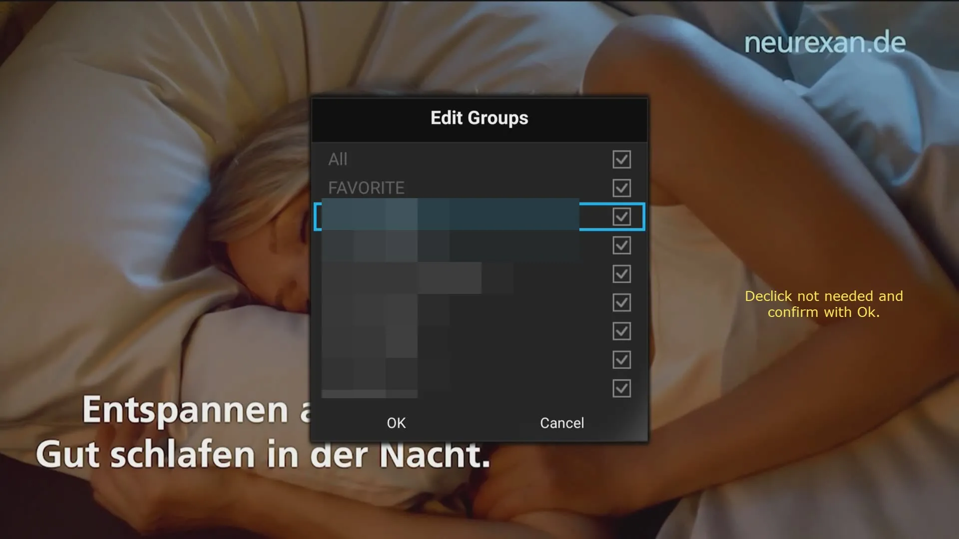

this is what i do to hide
MENU>Connections>>the service> ok> Edit>>Edit groups.
and uncheck what you dont want
