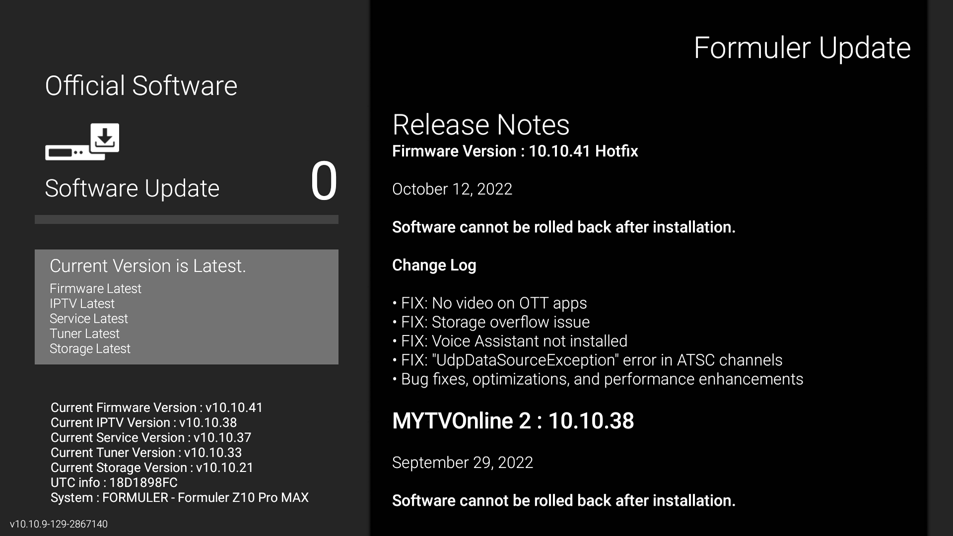

I will say, after performing the factory reset today, the updates seemed to happen successfully, I am in the process of adding back in my apps (youtube, twitch, studio optimizer, etc)...HOWEVER...as of right now the box is working better than ever. Seems snappier between menus and apps, I am getting more menu/schedule data in my IPTV...which was always an annoyance for me. So far, so good.
Great that factory reset solved the issue.
Yep...I think the factory reset fixed it. Sadly you lose all you data and info...wish there was a way to back all that up...HINT HINT Devs.
