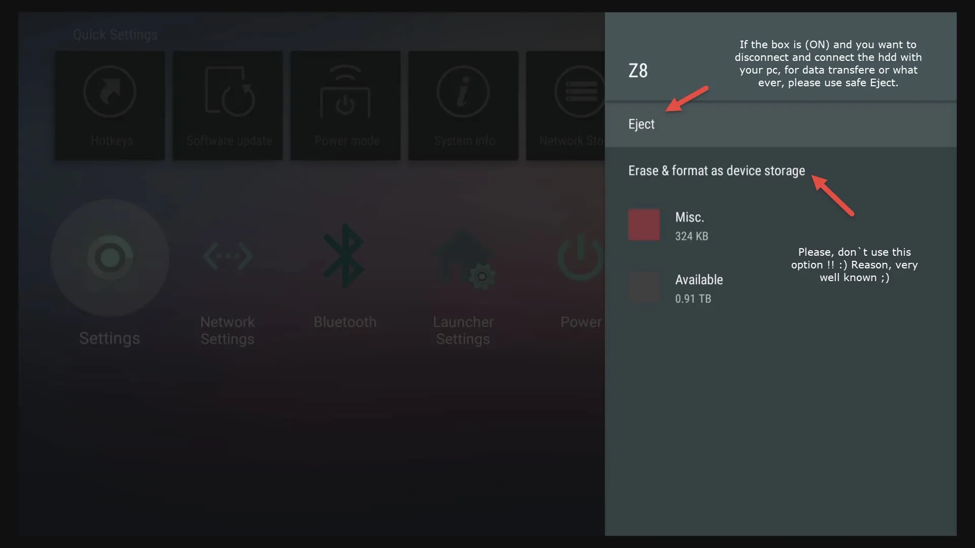

Settings --> Storage & reset --> Then I choose my WD USB drive -->Erase & format as removable storage.
The message:
Erase & Format
After formatting, you can use this USB drive in other devices. All data will be erased. Consider backing up first by moving apps to other device storage.
Keep in mind I am currently using this device storage right now. If you want I can follow the step above and reconnect to the box and tell you the message it gives me when connecting for what the box thinks the first time. When doing that the message is almost the exact opposite as the one above. Its telling you if you format this device then this box will only be able to use it.

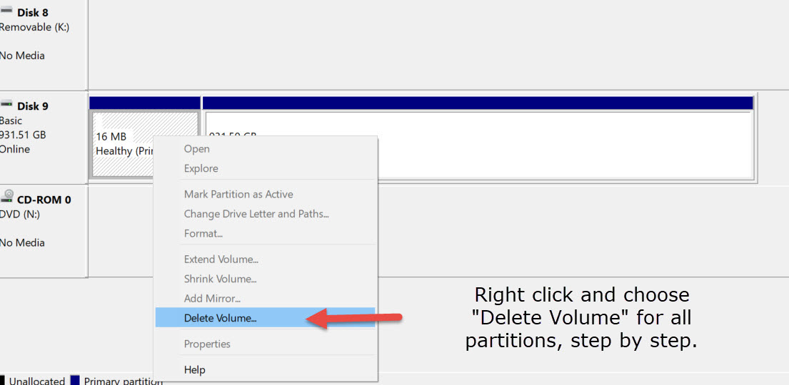

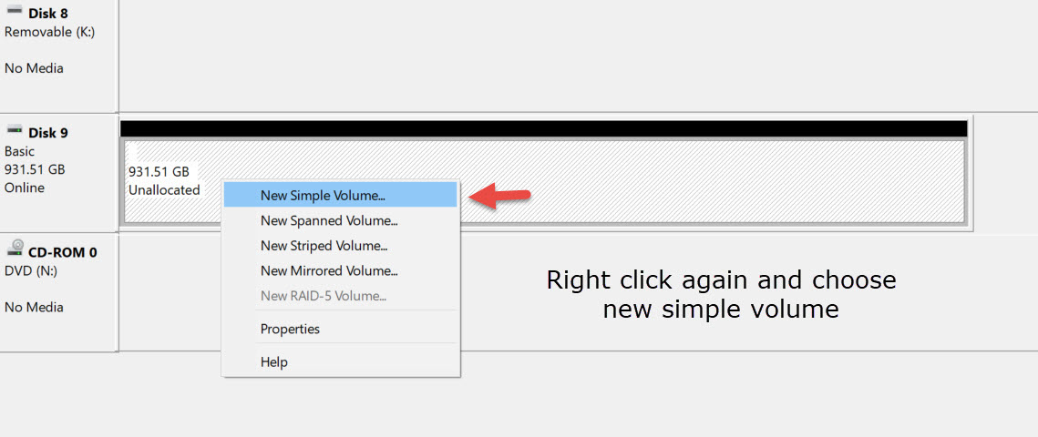

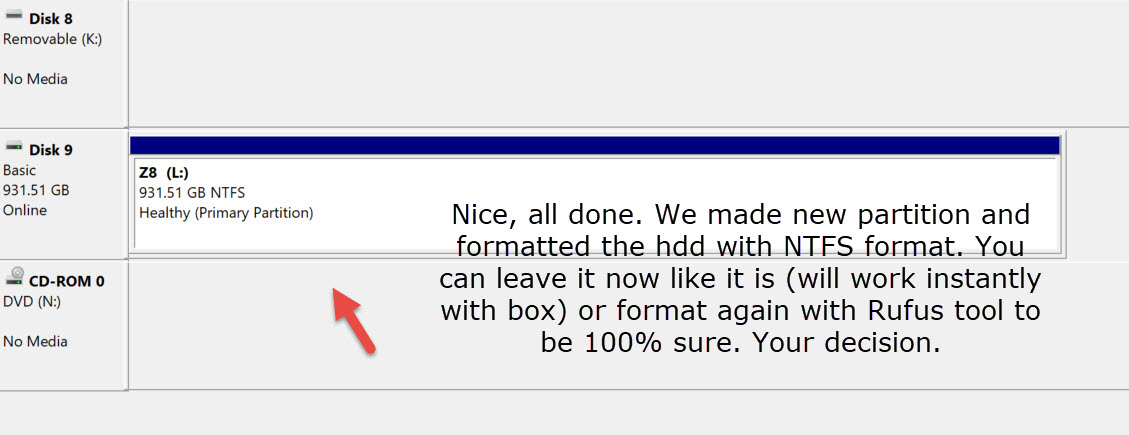

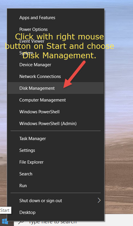

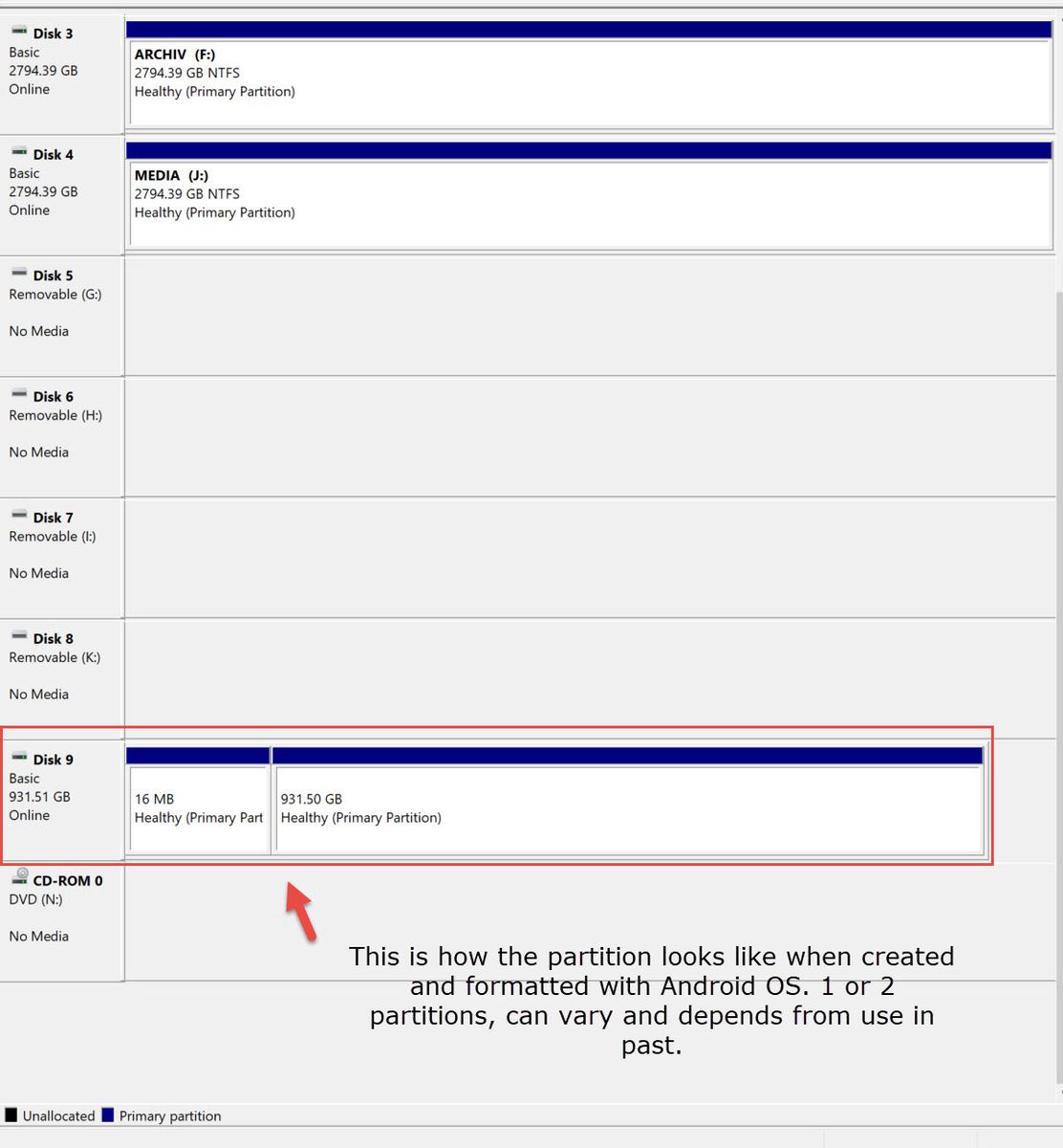

Ok, here is the solution for your issue, please do all steps like in following guide. I made for each step screenshots.
Once again for others, the Android possibility to format hdd on the box, is not recommended! Why? There are to many limitations with such way of format, like not visible folders, hdd is only visible and usable with box etc.
Before you use your fresh hdd with Z Boxes, please make one partition and format always on pc and connect then to your box. If formatted like in our Article -> How to format Micro SD card, USB flash drive, pen drive, hard drive or SSD for use with Z and S Boxes. you will be able to use the hdd with box and pc for data transfer and similar without any issues.
This Guide shows, how to make the hdd again visible on pc, so you are able again to make new partition, format and use it like from us recommended.
1. Disconnect your HDD from Box and Connect with PC (in Guide is Windows OS shown). In some cases the led from hdd will not instantly shine, because not recognised. Leave it connected and go to step two.
2. Follow all steps like in self explain Screenshots.

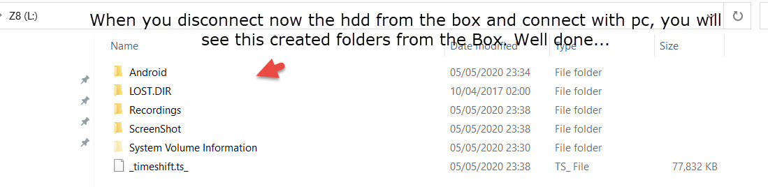

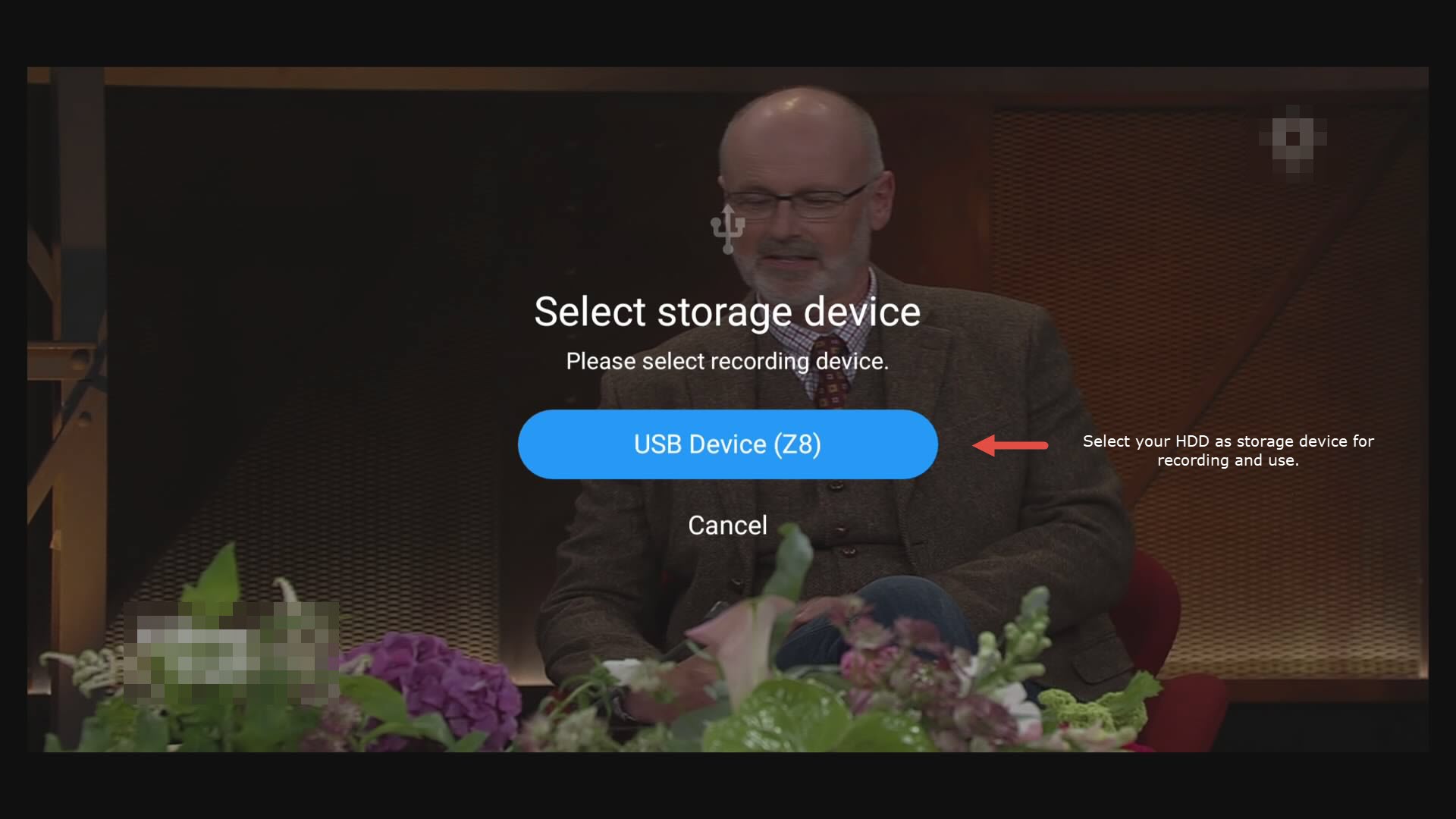

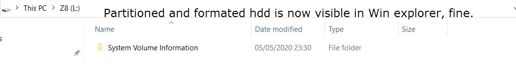

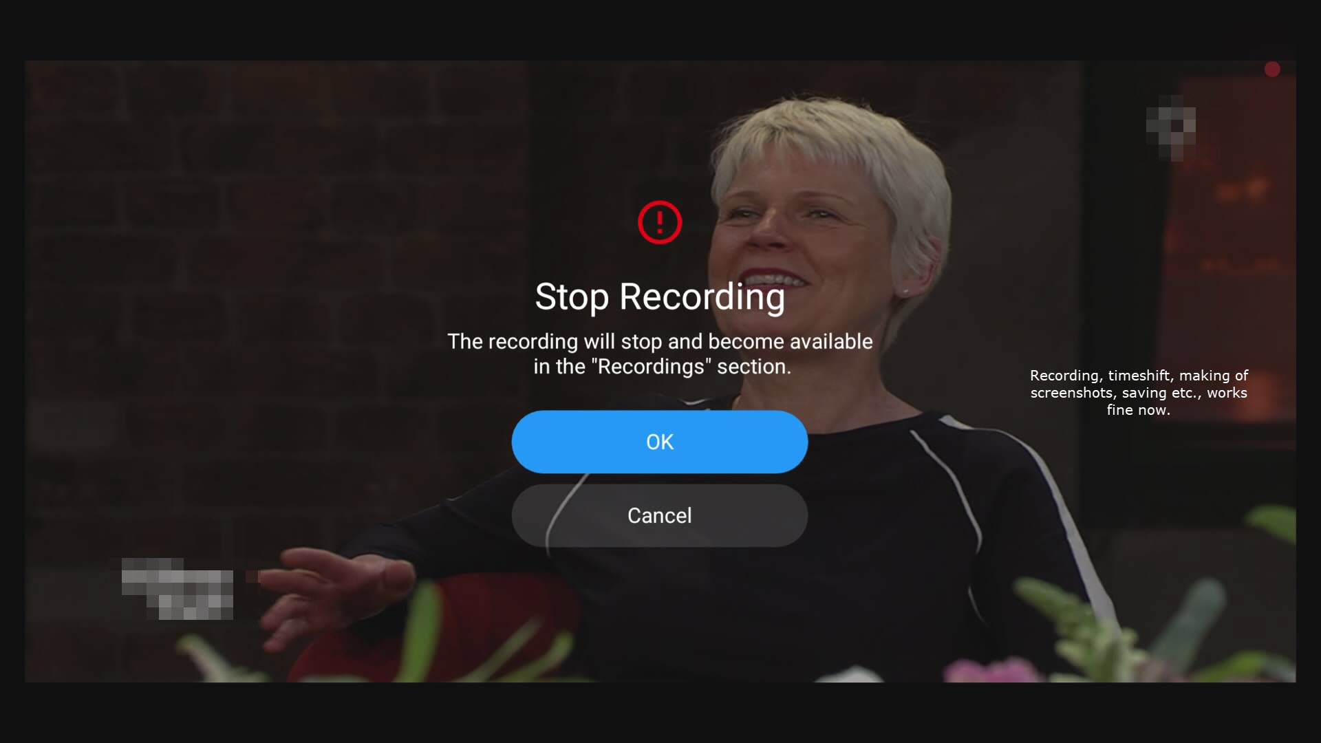

3. On Box.
4. PC
Done
