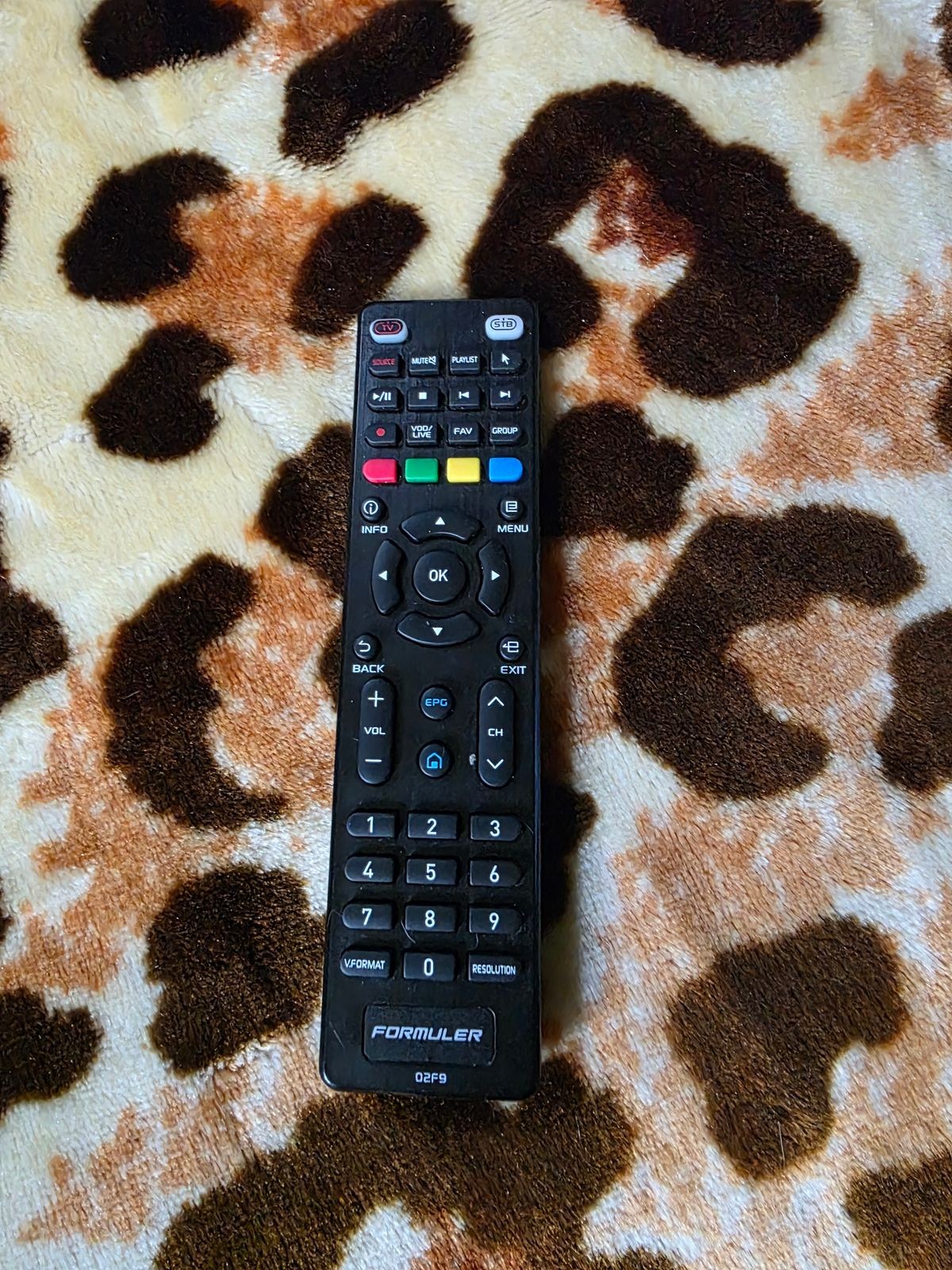

Hi everyone i have some probleme to pair my rc to the z+neo
Can tpair my rc to zplus neo
- Help
- Z+ neo
black hawk -
December 27, 2025 at 4:57 PM
Isnt it wrote on the back?
you're setting it to learn TV codes, hold the TV button for 5 seconds until solid, then the button you want to program and the corresponding button on your TV remote, touching them.
The problem is that i can t pair it to the formuler !!
It's a infra red remote. Not a bluetooth remote!
It should work normal and direct The remote you have. Change batteries.
You can check if remote sends out a signal.
Take you phone, open camere app and look with your camera app to the ir eye. If you push buttons on your remote you should see via your phonescreen via the camera app blinking from the infrared eye when you push button on remote.
You have the newer 02F9 Remote with changed commands, i m not sure if the Z+ neo accept this remote. Check the last update for your Box and compare with forum updates if the needed firmware is installed. Z8 Boxes accept this RCU. The other without 02F9 would work instantly, there are no needs for any reprogramming or pairing( pairing btw only on BT remotes possible).
New batteries and light blinks in cell camera
And on amazon they said it works with z+neo
And just did update
And after update and reboot does it work?
Looks like a rc problem give it to a freind to clean it with a contact cleaner and it works fine !!
Thank you
This isn't Formuler original remote. Please reach out to the seller who sold you this remote.
